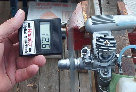

I'm running an APC 12.25 X 3.75 Power MASTER 15% stock muffler at 12,600 on a Morris Hobbies sledge 540 great combo for 3D Hovering and Torque rolling. and with my JR 10 X I can desensitize the throttle response RPM around the hover stick position for precise RPM control 1 ft off the ground in a hovering toque roll. good engine choice, very reliable once set never quits until you want it to!!!!

Default OS 50sx
Wow that is an awesome picture. But man it looks dangerous.
I would never get that close to a spinning prop arc (especially @ 12,600) but I appreciate you doing it for us.
