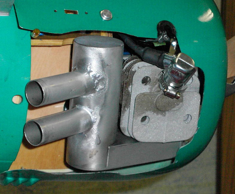

Hello,
More 3.2 numbers
Same equipment and gas.
I removed the 5/8" exhaust pipes and soldered 1" pipes to the Bisson muffler.
200 RPM boost!
I use Amsoil Series 2000 2-cycle racing oil mixed as directed at 50-1.
This time at an OAT of 32 degrees F giving me a density altitude of 1500 ASL.
Beautiful February day!
Measured with a TNC tach.
Menz 22x10 "S" 6800 RPM
24 lbs thrust as measured with my spring scale known to be accurate in rough water weighing freshly caught fish!
This is in my Sig Sukhoi that weighs 16.25 lbs.
Nice performance!

Hi,
Photo of 1" pipes on my 3.2.
I changed the angle to suit the Sukhoi.
A little more noise...doesn't matter where we fly.
200 rpm boost in power.

that sounds like a plan did you notice the increase in noise or power?
