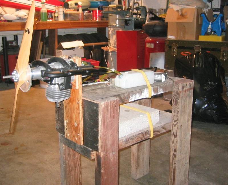

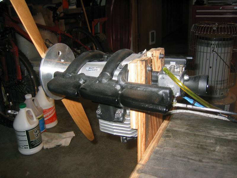

This is my other 3w-50i, also with a Keleo live exhaust, this one the "three stub" Merlin style. Second tank of gas, 32-1 Penzoil Oil for aircooled engines, 3w 22-10 prop. 6100 with an idle around 1800.

Sam,
That is so kewl ! is this going in a TF P-51 or something else Merlin Powered ?

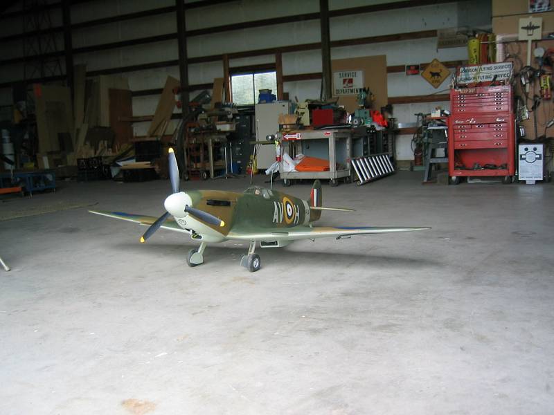

This is bound for my Vailly Hurricane. The twelve stub version on my other 3W-50i is in my Pica Spitfire, currently undergoing a wing replacement. Here's a few pics.

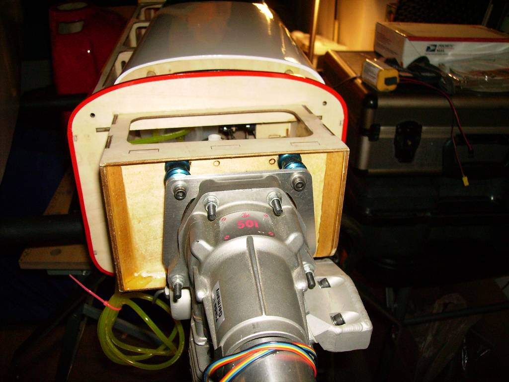

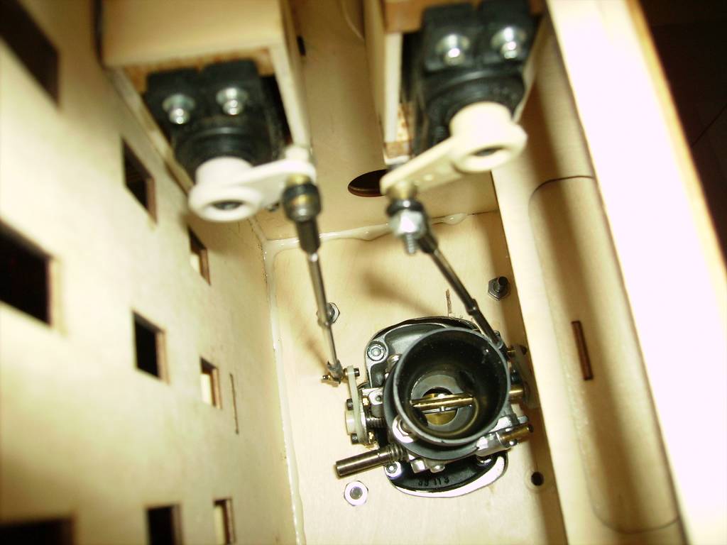

All,
I crashed the QQ Yak thru no fault of the motor just me being stupid. The 3W-50I has sat for three years and not run. I have been flying 80-100 cc planes and now I have finally come back to 50cc. Pulled the three dubya out and installed it in a new Wild Hare MX-2
and ran today on a 3W 22x10 wood prop.
Temp 80 degrees
humid 54%
wind calm
3W 22x10 wood 6600 almost 6700
idle 1600
32:1 Penzoil Aircooled
Also ran a DLE-55
Biela 20x10 three blade
6800
1600 idle

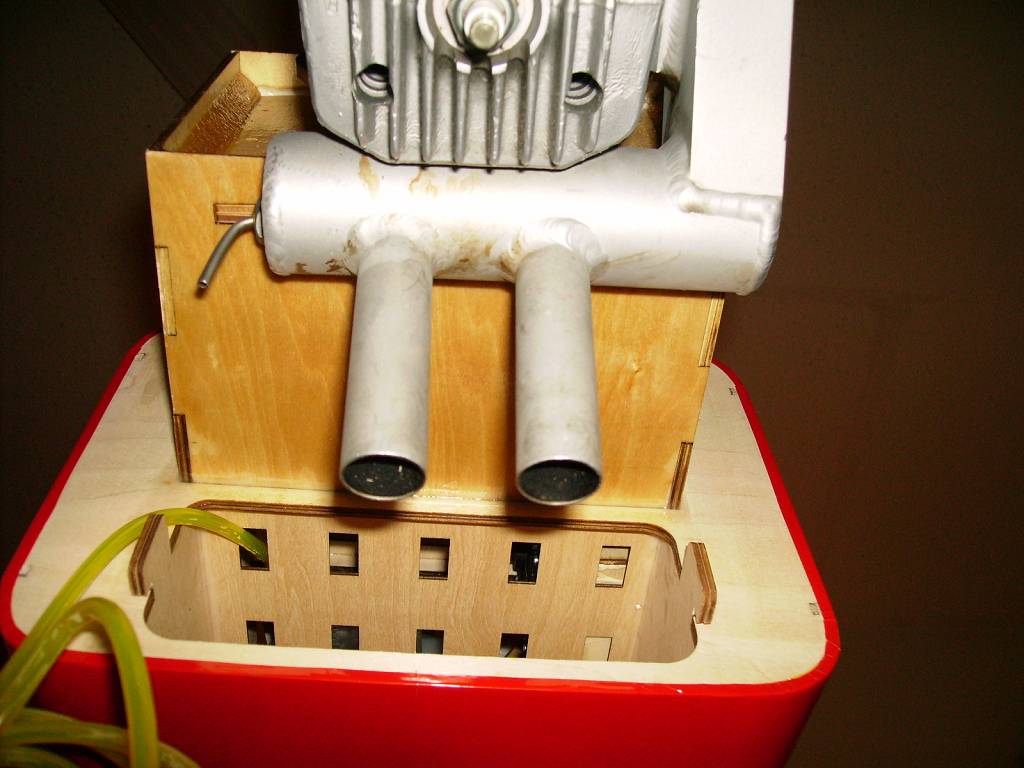

more 3W-50I pics
These not so good pics are the same engine different muffler system on a Cap 21 that it never flew on.
I took the good engine off and installed a Brave Heart 50 on it instead.
