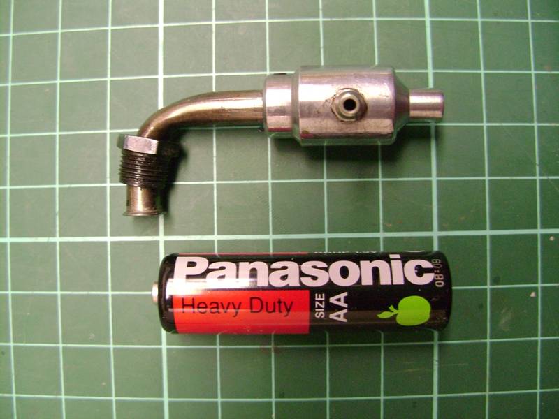

Here is the pic of the OS 20FS muffler that came with my engine......as you can see, it's very tiny - 30 mm long & only 13 mm at its widest point. Placed alongside a AA battery for size reference

Default RE: OS FS-20
It's neat! I want one!
