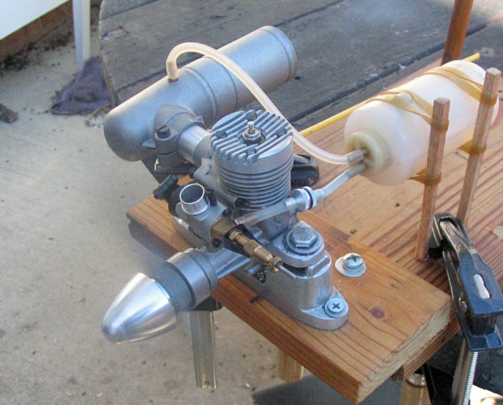

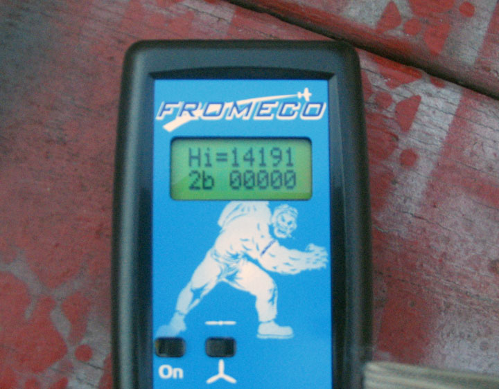

Super Tigre Schneurle S.29
Powermaster 5/22 GMA
APC 9x5
14,191 a bit rich
3.6lbs static thrust
0.59hp

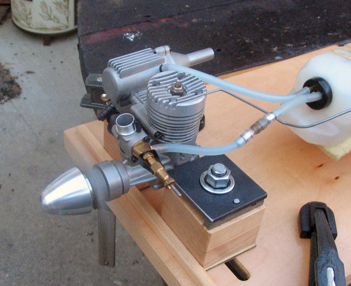

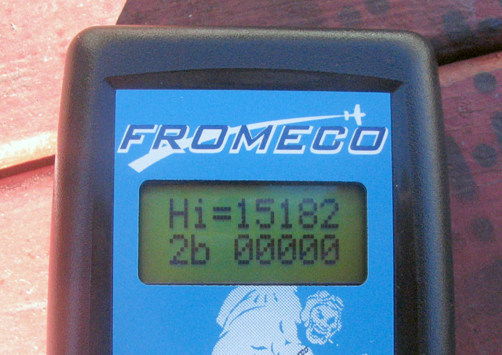

Old 12-30-2008 | 01:32 PM
rainedave's Avatar
Joined: Jul 2005
Posts: 6,344
From: Richmond, VA
Default RE: Super Tigre S.29
I installed a new G.34 Silent muffler on the S.29 and ran it some more. These ST mufflers are impressive. I gained 991rpms and the sound level was considerably lower. Amazing.
Temp: 64°
Powermaster GMA 5/22
new OS A3 plug
APC 9x5
15,182 peak
static thrust 4.5lbs.
.72hp
David
