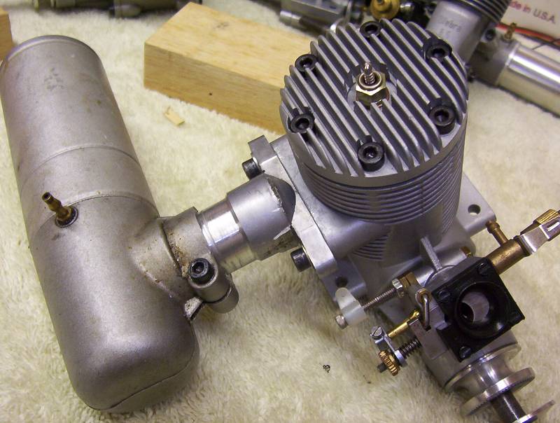

I spent the better part of the day running it and breaking it in.
Here are the numbers with Omega 15% and a short plug. I wanted to use 10% but I am out. This is using the stock Webra 40/50 sized muffler.
M/A 11x7 14,000
Zingali 11x7 13,800
M/A 11x6 14,950
M/A 10x7 15,800
Not bad for an engine that is basically in a 40 sized case.

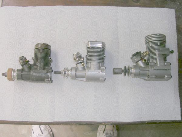

Pics show the muffler used and the 55 between an old speed 50 and a RE Speed 60 for size comparison.

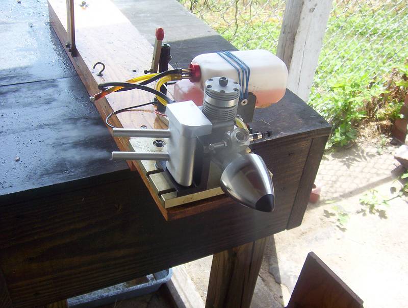

Dave, here is another DynaMix that draws fuel just fine using only muffler pressure. This is a brand new .91 I found a whaile back. I have 3 .91s now, two ringed and one ABC. The ABC is a Diesel conversion.
Also a shot of my Webra Dykes ringed .50 Diesel conversion turning a Graupner 12x7 at about 9,650 with the stock baffled muffler and 9,950 with the Bisson pits in the picture. Its a fine Diesel.
