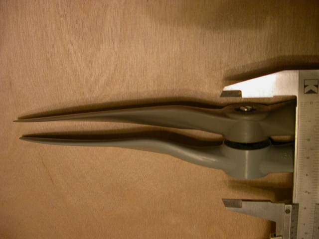

Appearances could be deceiving...
I know the specs do say the hole in the prop is drilled to 8 mm, but from measuring the dimensions in the photo, it seems to differ...
If the hole is indeed 8 mm, the hub is HUGE at ~34 mm in diameter.
For reference, I took a shot of a used Master Airscrew 11x6 Series-2 black prop, drilled to 7 mm, with my vernier caliper open to 34 mm around it.
Its hub diameter is just 24 mm.
See below.
I know an APC has a larger diameter hub, but the Graupner G-Sonic does not seem to be any larger than it is; and the APC hub measures up to only 1" (25.4 mm), according to the Tower Hobbies photo.
Can anyone verify that the actual diameter of the drilled-through hole, in the G-Sonic 11x6 is really 8 mm?
Photo analysis does not make it appear so.

Hi Guys,
I do not have 11x6 but here attached are 13x10 photos; G-sonic hub is same
diameter as APC but it is thicker. Also attached are photos of 16x14 G-sonic-pro
from different angles. The shape seems not "smooth" a bit 'extravagant'....[sm=shades_smile.gif]
My 11x6 G-sonic props came in Friday but I couldn't find an insert for the 8mm opening in the prop to use them. That is more than likely why they are hard to find in my area. They need to make them in 1/4" shaft so that they would work with more engines. That way if someone needed to ream it out, they could. As soon as I find an insert, I will give them a try. I put an APC 10x8 on it and retuned the pipe and really like this combo though. Good speed and decent climb. I've tried this prop before but didn't like it very well because the idle had to be upped a bit and it didn't want to slow down for a landing. I put a decent sized screw-on aluminum prop nut on it to give it more mass and that made all the difference. Idle was nice and slow and the plane slowed down decent enough for an easy landing.
Also my two G-Sonics came pretty well balanced which was nice.
