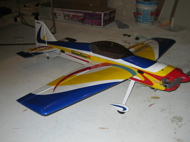

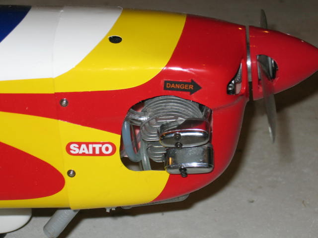

my showtime 50 saito .82 spektrum dx7 ds821 servos with hitec 5645 on the rudder. i like to route the crank breather line down the landing gear for less clean up. the pup wanted in.
