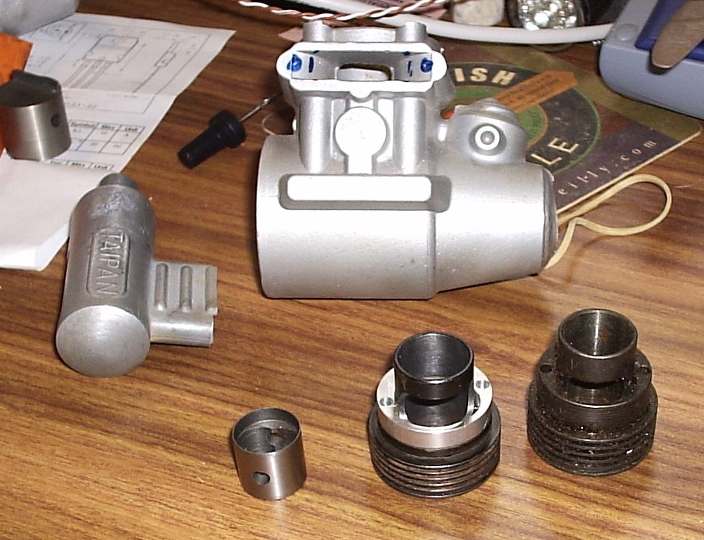

Worn out LB's receive a makeover - and the old Taipan design grows some fangs!
In 2011 I acquired two further very battered early run LB's from an estate. Each was in considerable disrepair with various parts broken or missing. I wondered what to do with them. Sell? no, I could not do it, and who would want them? Bin them? in all conscience I could not do that either.
So, late in 2011 I sent them to AAmotive as a gift, with another more collectable Taipan for renovation, thinking perhaps they could be used for parts as donor engines. My belief was they were beyond repair. How wrong I was.
David Burke, CEO of AAmotive said he wanted to put the good bits from the two old engines together for use in an experiment. He required data to validate a proposed revisiting of the style of porting originally anticipated for the engine for it's proposed rebirth as conceived. Would I agree? And if so, could I do some testing for him? Umm ... does a bear ... in the woods? Delighted to help, and excited at the prospect of this long dead model being re-born, there could only be one answer.
Shortly thereafter a parcel containing an engine made up from the old LB's arrived on my doorstep. "It's a Taipan Jim; but not as we know it" my mind whispered when I looked through the exhaust port. It had a new piston and cylinder ... and I mean new, as in a new cylinder with obviously modified porting! Compression felt very strong. I was directed to do some back-to-back testing on a range of props with my original LB as a "control".
Could this "bitzer" hybrid with it's new piston and modified cylinder outperform my never dissassembled example?
Testing, testing and more testing ... with the result being vindication of concept

The converted engine displayed no bad habits. It started readily by hand despite being tight, and was always smooth and well behaved. It was if anything even easier to hand start than my original spec LB.

After seeing the hybrid LB perform (perhaps as the LB always should have!) you can imagine the grin on my face when David offered to convert my old LB to the new porting as reward for carrying out the tests. It took me about 2 milliseconds to accept. It may also be converted to diesel, but that is another story. I am informed it will be the sole AAmotive modified plain bearing LB with vortex porting. However, is all this experimenting leading to a dead end? Definitely not!
While AAmotive will not produce another plain bearing LB, they have the original Taipan tooling for the twin ball race ('LB TBR 15') version of the engine incorporating vortex porting. The mission is to volume produce it for sale. It will suit a number of specialised competition classes in F/F and C/L. Development is well under way. All being well the re-born ball raced LB engine will see the light of day, as originally conceived. Mufflers and an R/C throttle will also be offered to maximise its appeal.
Is it intended to compete with the latest chinese ABN/C schnuerle ported 15 size engines? No. It is designed to be a good, powerful sports engine of conventional lay out which will use best quality materials. Offering pride of ownership and lasting ruggedness, there will be full spares and factory servicing back up at fair prices. In other words, it is to embody all of the qualities of the 'Taipan' marque. An engine with heritage offering lasting value.

[b]Photographs[b]:
Images 1 & 2 - original LB (black head) with hybrid LB (natural head) prior to testing
Image 3 - hybrid LB spinning a test APC prop during running in
Image 4 - original cylinder from donor engine (all black) and hybrid cylinder (with natural aluminium insert). Crankcase in background is for a different (larger) AAmotive prototype engine.
Image 5 - "raw" crankcase casting of proposed new LB (as per original conception with provision for front ball race) and an original silencer with some minor damage.
