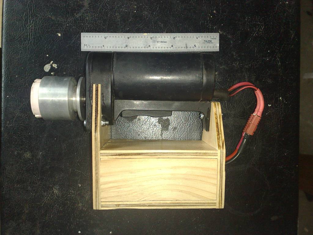

Old 01-05-2011 | 06:11 PM
Joined: Nov 2007
Posts: 104
From: Thomasville, NC
Default RE: Starter battery powered
luker,
This topic has come up before, but this is how I did mine (see pictures). The battery is from Harbor Freight (paid $10 I think) and I made the "holder" out of wood and covered with black adhesive covering.
ID:	1543009   Click image for larger version
