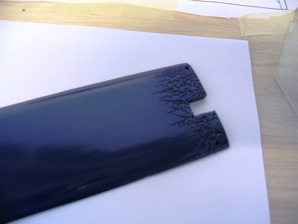

Interesting comment here on Minwax Polyurethane. I'm presently finishing a planeusingRust-Oleum Painter's Touch. I tried applying Lusterkote Clear over the rust-oleum, but it crazed the finish in a matter of seconds. I'mtrying Klasskote Clear epoxy next. I'm going to have to test the Minwax Polyurethane for fuel proofing.
Jim
