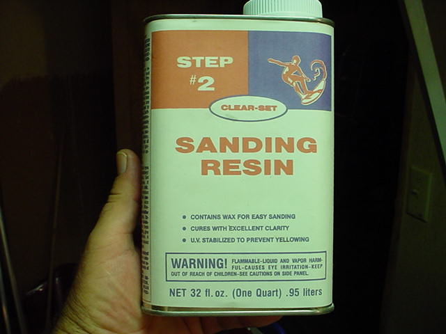

This is the stuff that is made to fill the weave in a glass
job....the hot ticket is to thin this stuff with "styrene
diluent"....it makes a real flat, easy to sand surface.
Dave.

where do you get this stuff?
as in the photo above
Old 08-20-2003 | 06:22 AM
Flyboy Dave's Avatar
My Feedback: (21)
Posts: 13,864
Received 10 Likes on 10 Posts
From: Pinon Hills, CA
Default av8r4aa....
....at a fiberglass/plastics supply house. If all else fails....
....Hastings Plastics....Santa Monica, Cal. (they ship)....
....310-829-3449....

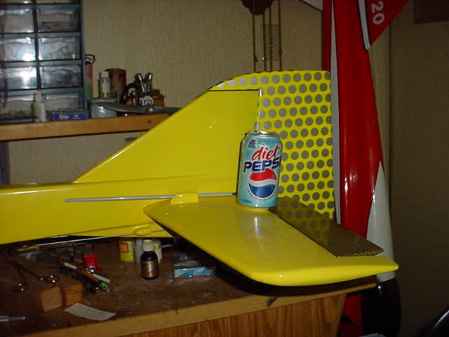

here's a spray can paint job....over the sanding resin,
and primer....(auto enamel)....
