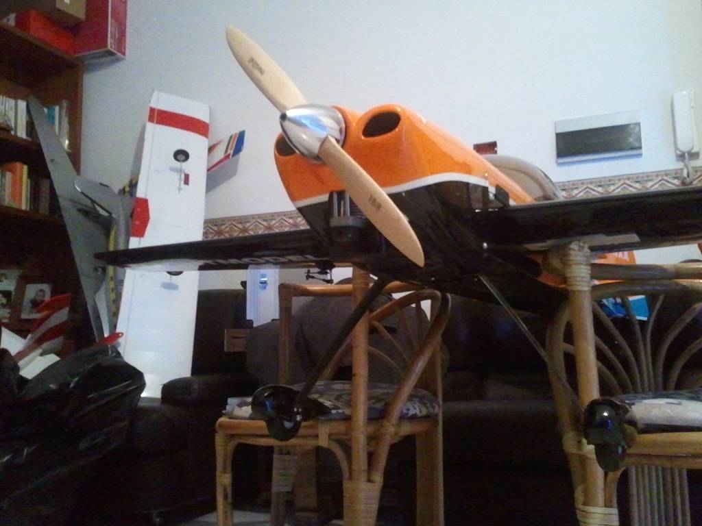

I had trouble trying to balance a large model, Sbach342 190cm wingspan by myself.
I cut 2 pieces of 3 mm ply from some scrap, cut 2 pieces of tubing, 5mm od and glued them to the ply pieces .
Taped these new "balancers to the wing, underneath, with masking tape with the tubing at the indicated cg.
Placed the model on two chairs so that the tubing could "roll" freely and voilĂ*...done.
See attached pics.
Dino

Very ingenious solution! Though low winged aircraft are typically balanced while inverted, I can't see where the CG would be any different.

Nice idea! I use two scrapes of thin ply one of which I partially drill an indent, glue the two together and tape centered on CG on both wings. Then use two phillips screwdrivers to balance. This way you can use short screwdrivers for biplanes. I bought one of those Sig balancers and thought I was building a plane, then it didnt work with any of my larger planes.

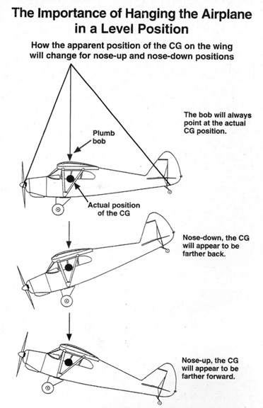

These slings will work on any and every plane. Just don't drop the plumb bob on the fuse. :-)
david

An oldtimer taught me this method several years ago. He called it "The Center of Neutral" method. It is a very accurate method of CG placement and it becomes more accurate if you attach the sling directly at the tail and nose of the plane. It has several drawbacks, though. First, you need to make sure that the thrust line is perfectly level. If it isn't, the CG will be way off from where you measure it to be. Of course, you need to use a level with almost any method to be the most accurate. Secondly, you need a lot of patience waiting for everything to stop swinging. Third, though it might be considered an advantage, you must balance the model laterally first to get it to sit in the sling. I've set my CG using this method and then put the model directly on the CG Machine for comparison and frankly, the only difference was that this method was more accurate as the point on the plumbob was easier to finely mark than the "pads" on the CG Machine. The two results were otherwise virtually identical. The CG Machine had the advantage of being much quicker and easier.
