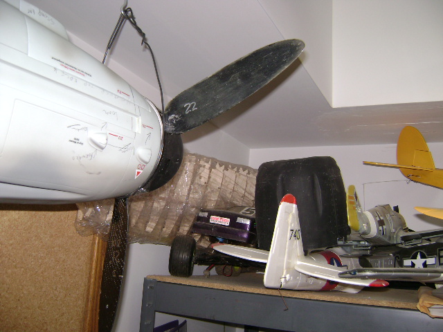

The plugs are made from hard balsa,(easy to carve and shape) when I have a blade I am happy with, I then put it in a parting frame same as you would a fuse,wing,or cowl ect. and finish the mold.The lay up is free hand, keeping very close count of lams (blade vs blade) to help in the balance dept.I then close the mold, and vacuum bag with heating pad @80*f.After the prop cures I remove it from the mold,trim and balance.In some cases I will post cure the blade @140*f for two hrs. to strengthen the blade overall. If you do not want to carve a blade, find one close and reshape it to your specs. and then mold it.Either way you will have endless supply of props that are very durable and you can call yours.Hope this helps. Good luck!Rob

HVACMAN has helped me in making my own prop blades as well. He has been making his own fuses, wings, stabs, rudders, spinners, vac form parts ect.......along with me for over 20 years.
Once you get the basic idea of composites, nothing will stop you if your motivated.
The phrase "never work" gets me motivated to make it work.
Steve

I will do it. I have time restraints at the moment so this may start off a little slow. If you are going to build along, gather these things:
-your plug or favorite prop (carving a prop is not difficult, but it is complicated so we will cover this in a different thread)
-modeling clay (I use Clean Clay brand)
-a metal dowl pin to fit the prop shaft hole (no slop, about 3 inches long will work)
-Epoxy (I use West Systems 105/205)
-Epoxy filler (Cab-o-cil, ect.)
-Epoxy surface coat (I use Dow Aluminum filler; works well, very strong)
-fiber glass cloth #2 #4 #6 for mold only (prop parts will be made with different weight, I will cover that later)
-PVA wax and liquid
-mixing and safety hardware
-most important: patience
Give me a few days to set up and we will get started. Rob.
