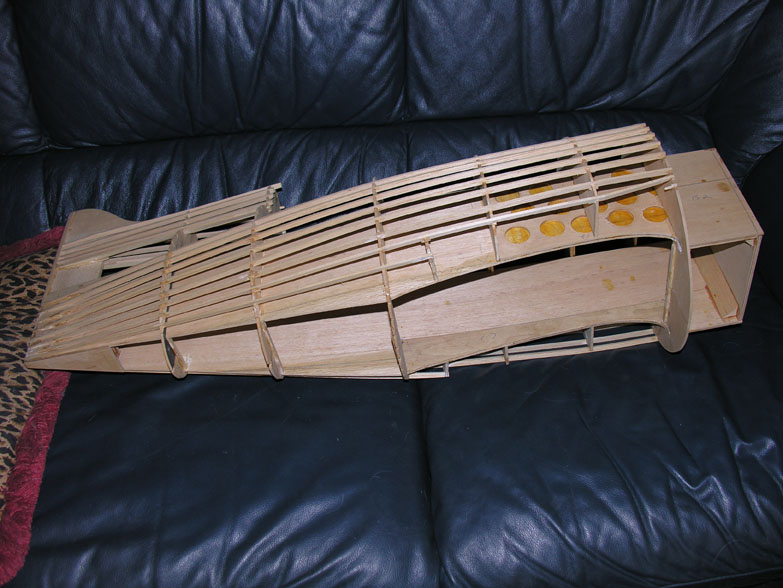

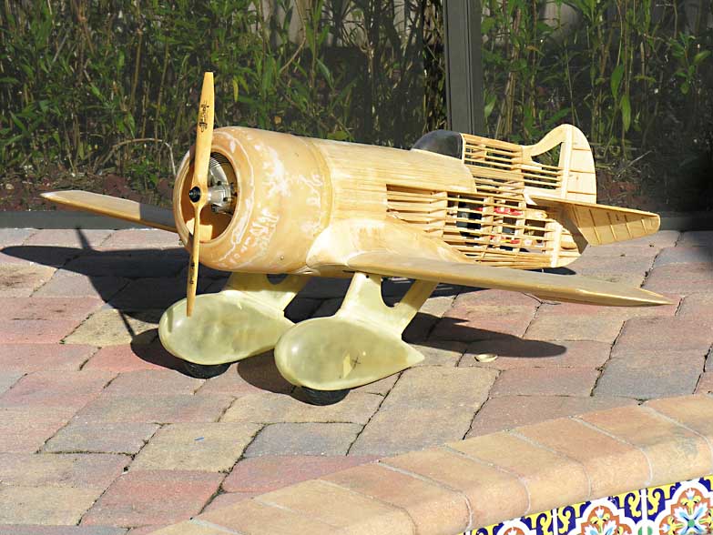

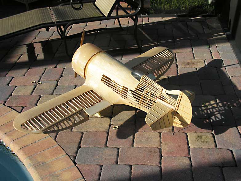

These models were framed up using only CA, 5 minute Epoxy and 30 minute Epoxy.
I just started building a few others, I'll get photos.
