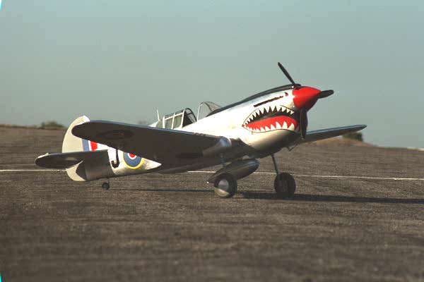

"What I would like to know is if Monokote will stick to a painted surface, "
It will, but the problem that you will have will be air trapped between the paint, and the Monokote, and perhaps in zillions of little bubbles that you cannot puncture with a pin.
" What paints, or coverings have you used to do something like this"
I used Chrome Monokote, scrubbed with a scotchbrite pad, and applied in panels in accordance with some Squadron publication I had.
Les
p.s. The control surfaces look funny, because, like the real one, they were fabric covered.

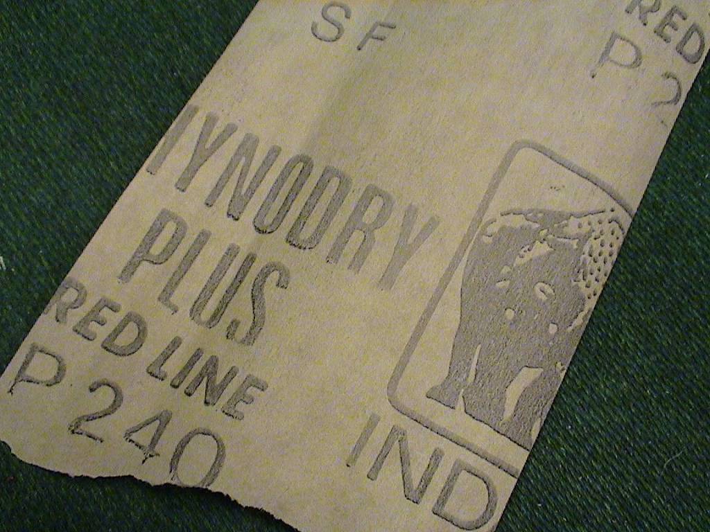

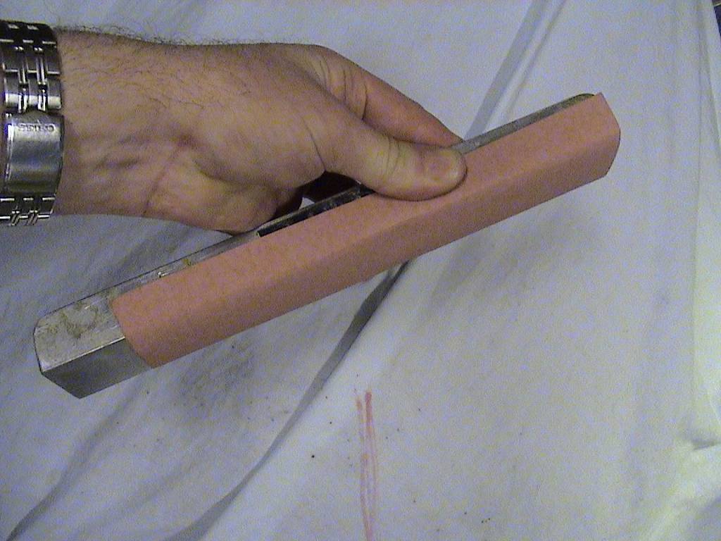

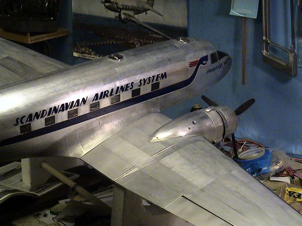

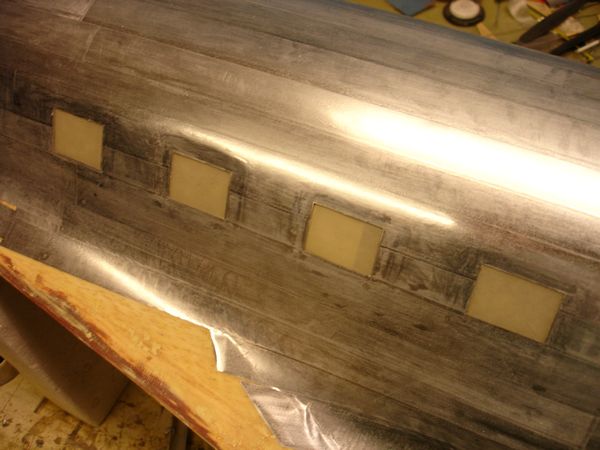

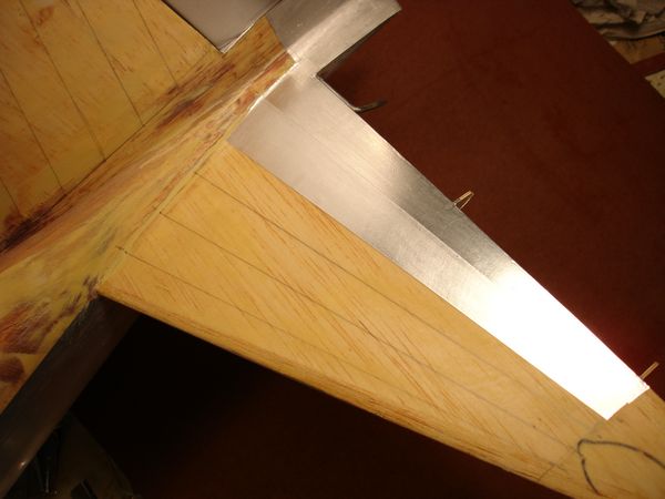

Hi!
Just start sanding!
Best sanding paper is made in Portugal by Indasa. 3M, Norton, Mica and all others brands are just not comparable to Indasa.
Could not belive it when I first tried it 15 years ago! The paper I recommend is called: Indasa "Red line" Rhino dry!
Then I would use Oracover Chrome! Not Monokote! Oracover is much better.
