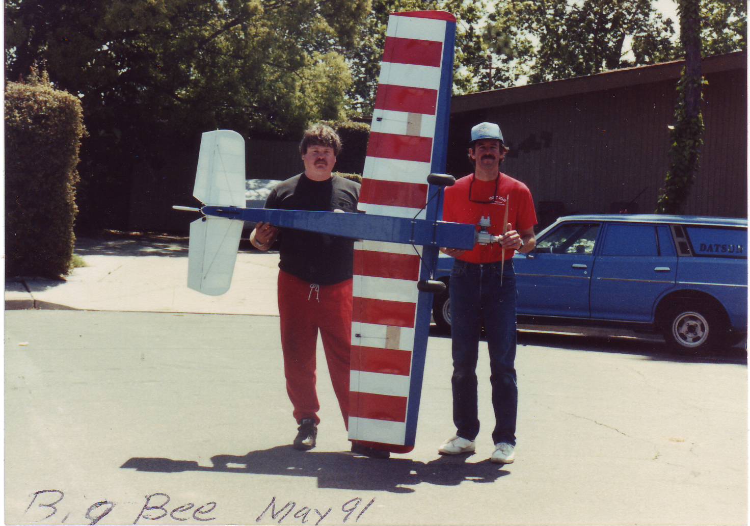

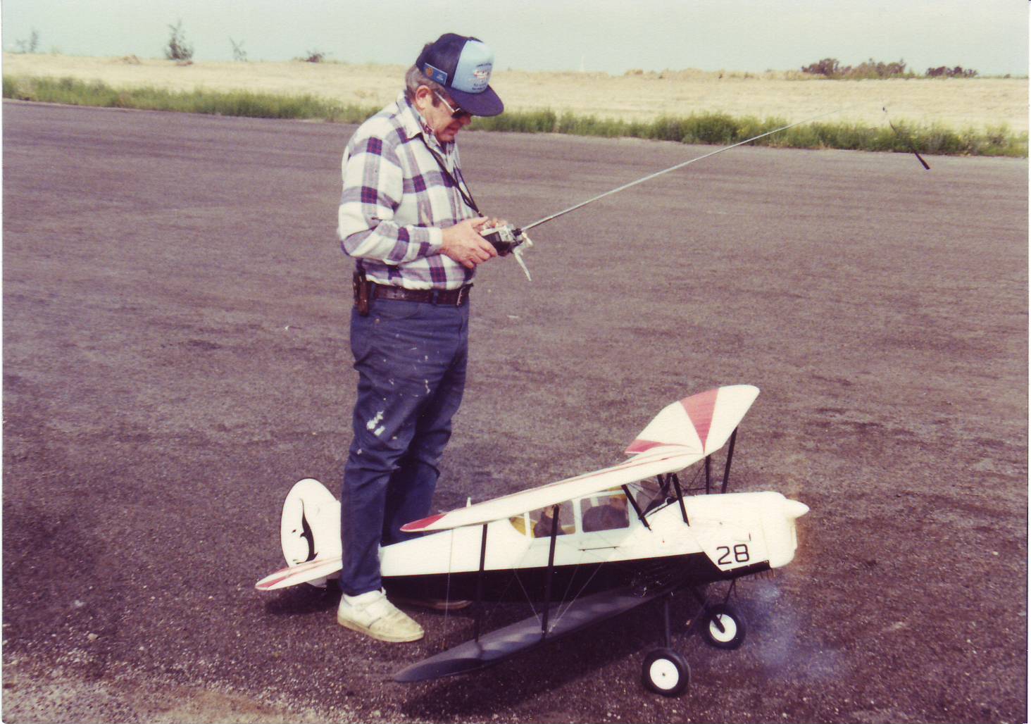

Isn't there a limit to the length a servo extension, before things get glitchy? Or am I wrong?
Old 02-06-2014 | 07:52 AM
Banned
Posts: 2,670
From: San Diego, CA
"Isn't there a limit to the length a servo extension, before things get glitchy? Or am I wrong?"
You are not wrong, but I have never run/ran into that problem.
And the kids and I have done this size.
Les
