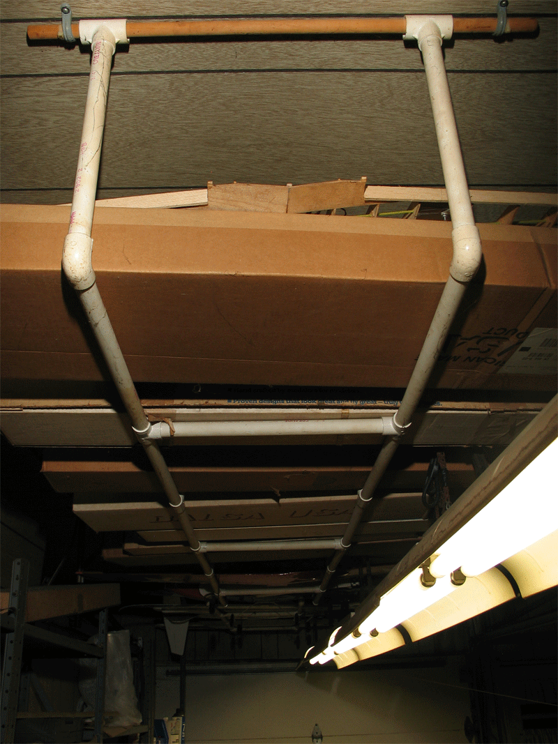

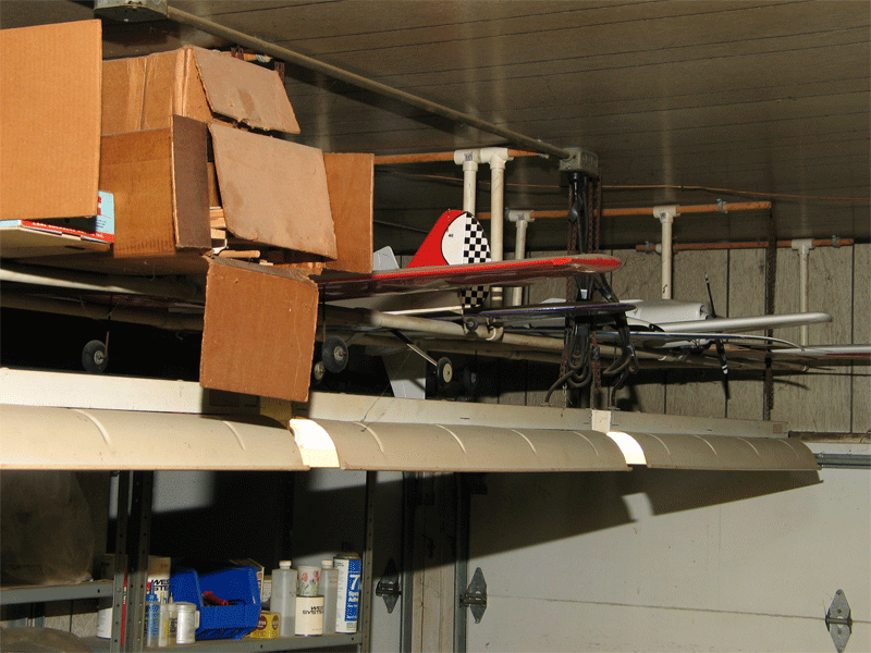

You can make a rack out of PVC pipe and fitting. Pretty cheap and they can store a lot of planes. I made this one and as you can see, hold a lot of planes. Yes my garage is a mess.
Buzz.

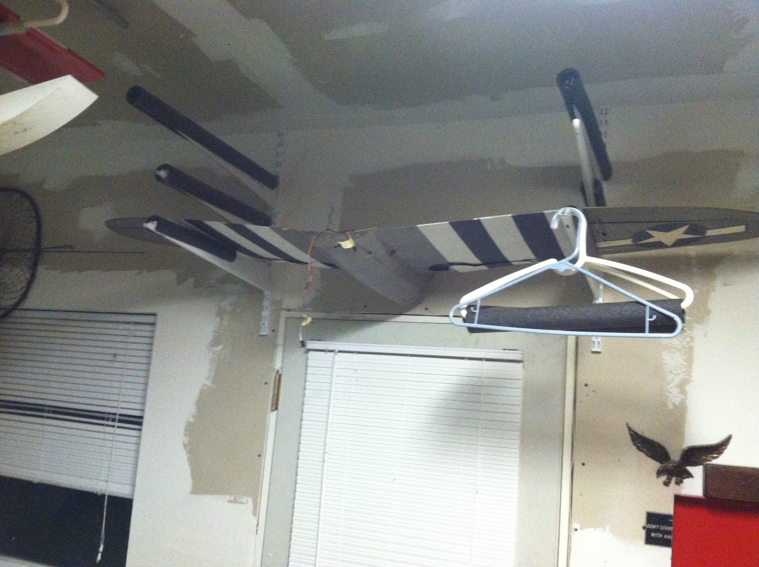

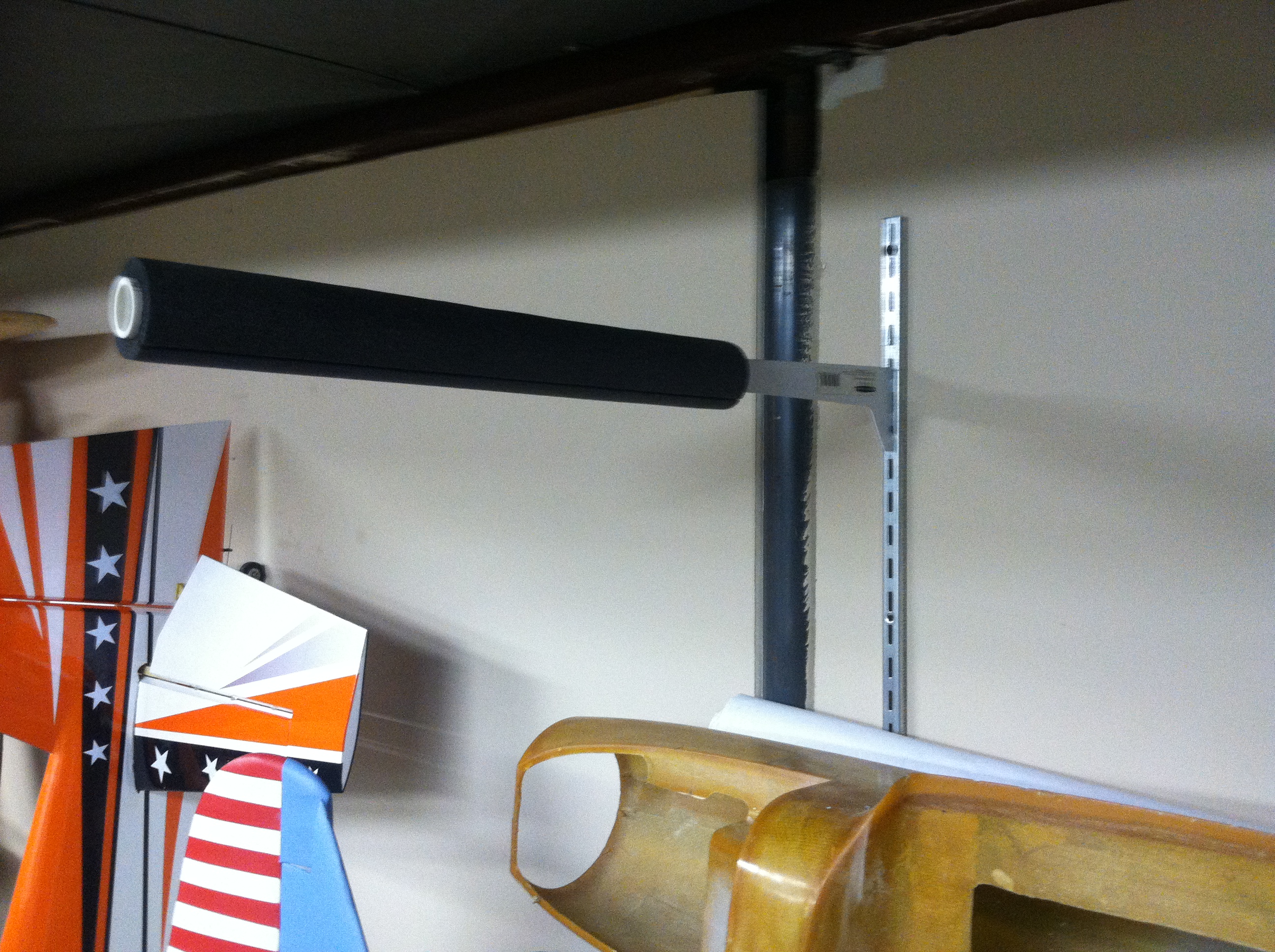

I use these heavy duty face-out shelf brackets sold at Lowes or Home Depot. out in the garage, the light duty single slot ones in the shop

The wall mount adjustable storage shelving systems but shop wisely or they can get pricey. Be sure to cover them with foam pipe insulation for protection. I was fortunate to get a huge bin full of this stuff and a pile of wall tracks at a tag sale for $10. Still using them today.

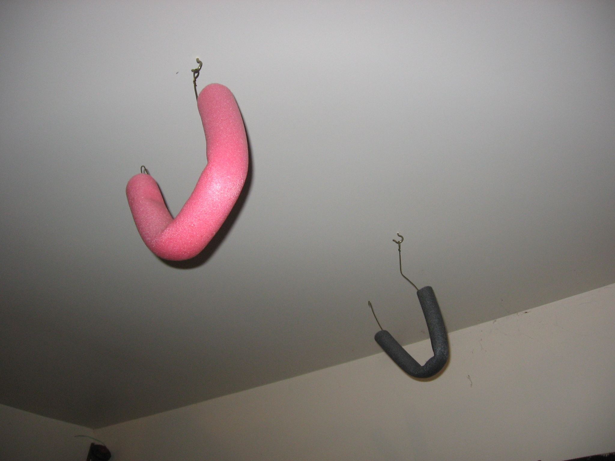

This is about as simple and cheap as it gets. Coat hangers formed into a loop with a loop at one end and a hook at the other end and covered with some pipe insulation. Screw hooks into the ceiling. ( joists of course).

I also use the shelf-brackets... with pipe insulation for padding. They aren't cheap if you're going to do a whole wall.. but I've got mine in my "plane room" which is about a 12x14' room in the house where I do alot of my finish work and tweaking(and web surfing). I've got 15 planes and several wings on a 12'Lx8'T wall.. and some wings too. Two of which are very large. A 50cc and a 30cc.. and several .60+ size planes. The brackets are very secure... and I'm pretty sure it would take a large quake to bring anything down.. if theres a quake that big.. there will be alot more problems then my model planes(of which are very near and dear to me too.. but just sayin..)..

Here's a rack I made several years back. It's made of 3/4" PVC pipe. With tee's and elbows. It's 18" wide and run the length of my garage. It works good for planes, boxes, and other things you might want to put on it. I had a hard time finding a good angle to take a picture. I think it gives a good idea of how it's made.

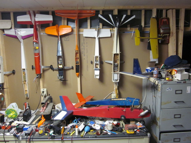

I kind of like thread # 5's idea. This is what I have been doing. It isn't the answer. I think I should do some airplane burning soon. I have got some larger planes since those pics, and two more wing racks.
