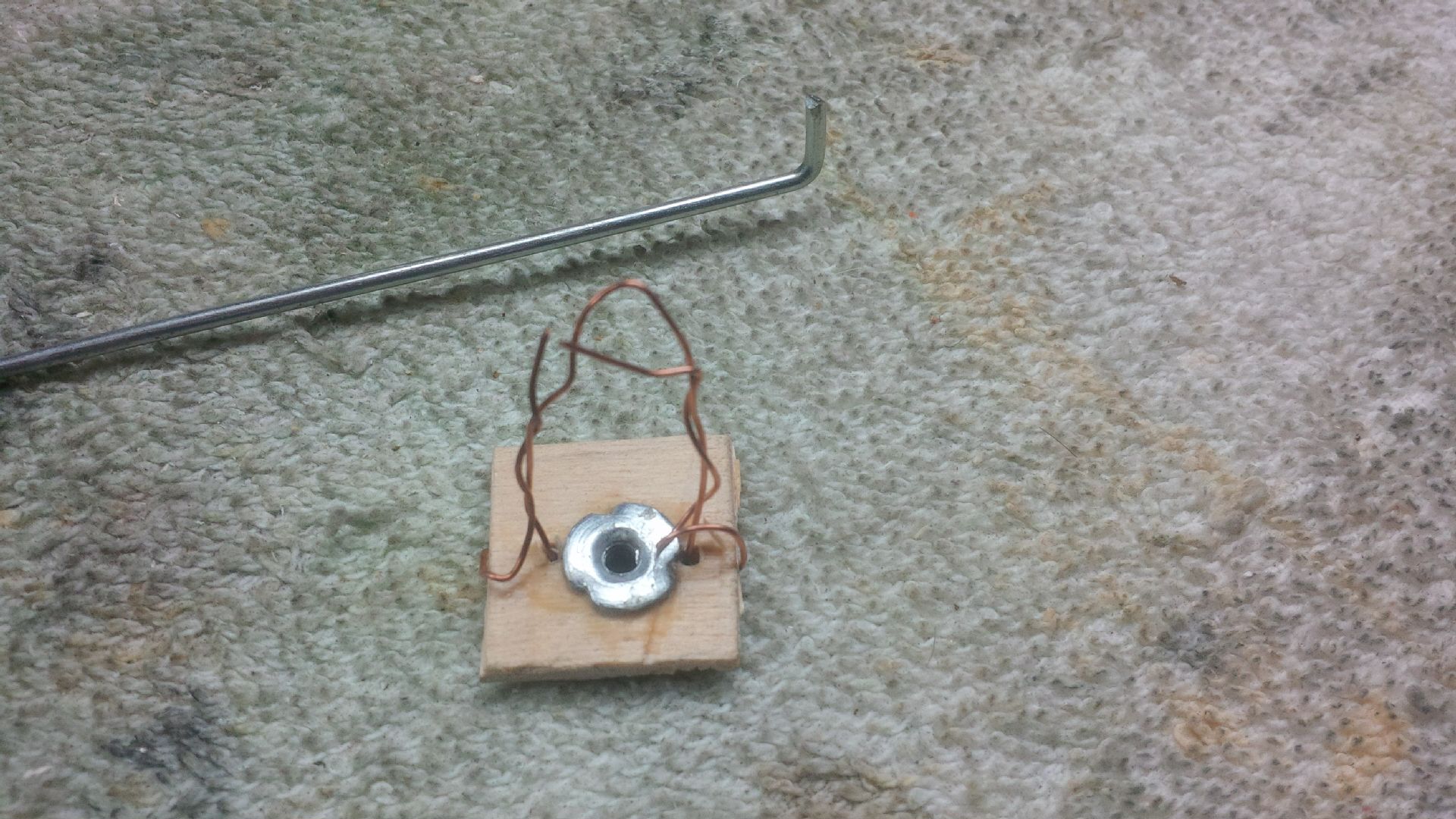

So I need so help here folks. I'm building an MSR and I went to assemble the tail wheel and one of the blind nuts came loose on me. So now I have the 3mm x 30mm blot that just turns. Can't tighten - can't get the bolt out. Only thing I know I can do is to get my Dremel out and cut the bolt which would obviously free the blind nut and I could shake it out of the rear of the plane. But if I did that, how do i reinstall a new one? Any tricks with out cutting up the covering? Thanks for reading.

Thank Robert. That is a great way to do it. I wish I had thought of that yesterday. Well it turned out that the blind nut had poor threading and I basically just turned the blind nut out of the wood. So here is what I did. I cut the bolt and was easily able to get the blind nut and what was left of the bolt shaft out of the fuse. I then made out of thin maple plywood a 5/8 x 5/8 square and put an mounted a new blind nut onto that square. I then made a handle out of thin copper wire to act as a cradle. I used a push rod and taped my cradle to the end of the push rod. I inserted it into the fuse down to the tail area and with the aide of a light I then used another push rod and through the hole in the bottom of the fuse I lined up the hole in the blind nut to the push rod. This was not an easy task. Once I was able to do that I then put 30 minute epoxy carefully on the bottom of the maple plywood and repeated what I just stated. Once I got the push rod through the blind nut hole from the bottom of the fuse, I then pulled the long push rod so my tape would come off and now the assembly just dropped to the bottom of the inside of the fuse with the blind nut lined up with the pre driilled hole. Right now my epoxy is drying, SO if my idea works, the epoxy should harden and the blind nut should be lined up - I just have to take the tape off the push rod that is lining everything up and insert my bolt and I should be good to go. Talk about explaining that - but I truly like your idea way better - its just that I know I messed up the wood inside so I figured I would be better off trying to put in a whole new piece of ply. I took some pictures of my assembly, if my idea works I will post.

Dennis - That is really a neat trick. That is super clever. I'm sure not easy to drill a hold through the center of say a 4-40 threaded bolt shaft and I'm sure its tricky to try to pull that assembly back and through the original hole in the plane, but with time I'm sure it works. Very clever. Well my technique worked and I'm attaching a picture of what I did. I chose my way only because I know when I 'unseated' the blind nut in the rear of the plane, I chewed up the wood that the teeth were mounted in. So with that said, I felt better to try and get another piece of small ply in that area. As you can see from my picture I just made small cradle and used a long push rod to get it to the back of the plane. I used 30 minute epoxy on the bottom of the cradle and I put some light lithium grease in the blind nut hole to prevent epoxy from getting into the threads. I then used a shorter straight push rod and from the bottom outside of rear fuse I lined up the blind nut hole with the short push rod so I was centered over my original hole. I then pulled the long push rod out and let the cradle fall into place. I taped the shorter rod in place and came back the next day, removed the short push rod and had inserted my new threaded bolt in place. Worked fine.
