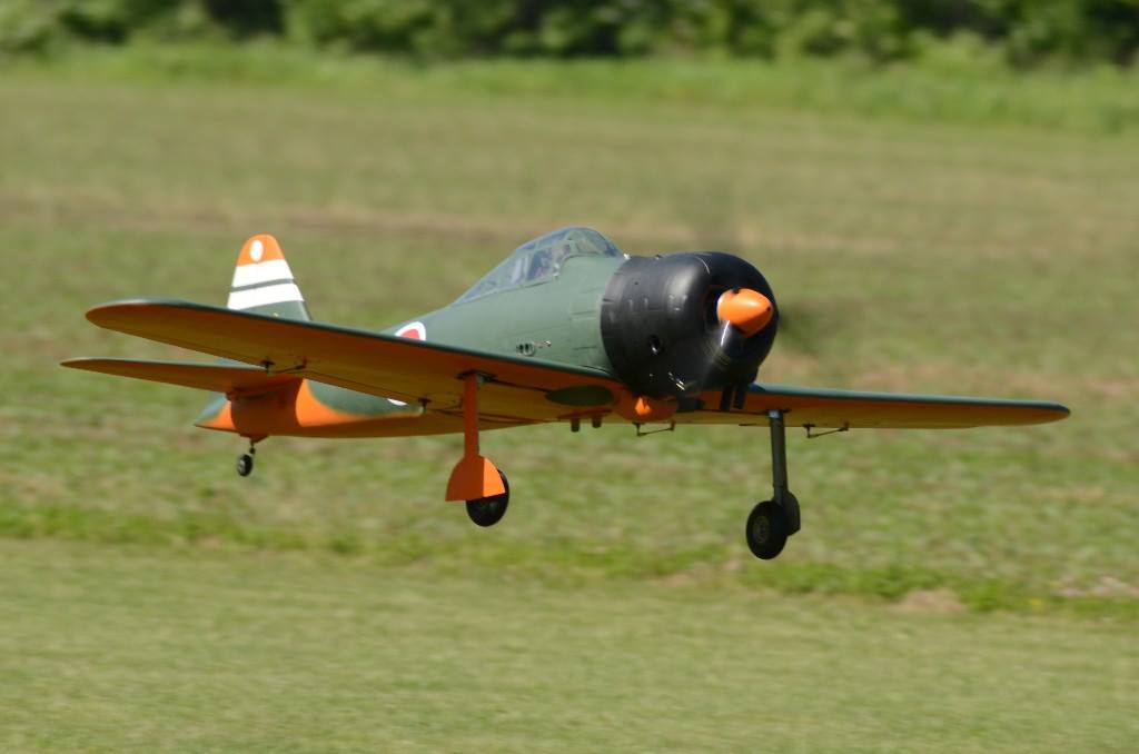

After trying all the thinning "tricks", I used just water on my last latex job,, came out nice,
Talked about in detail in this thread http://www.rcuniverse.com/forum/ques...-painting.html
good luck
