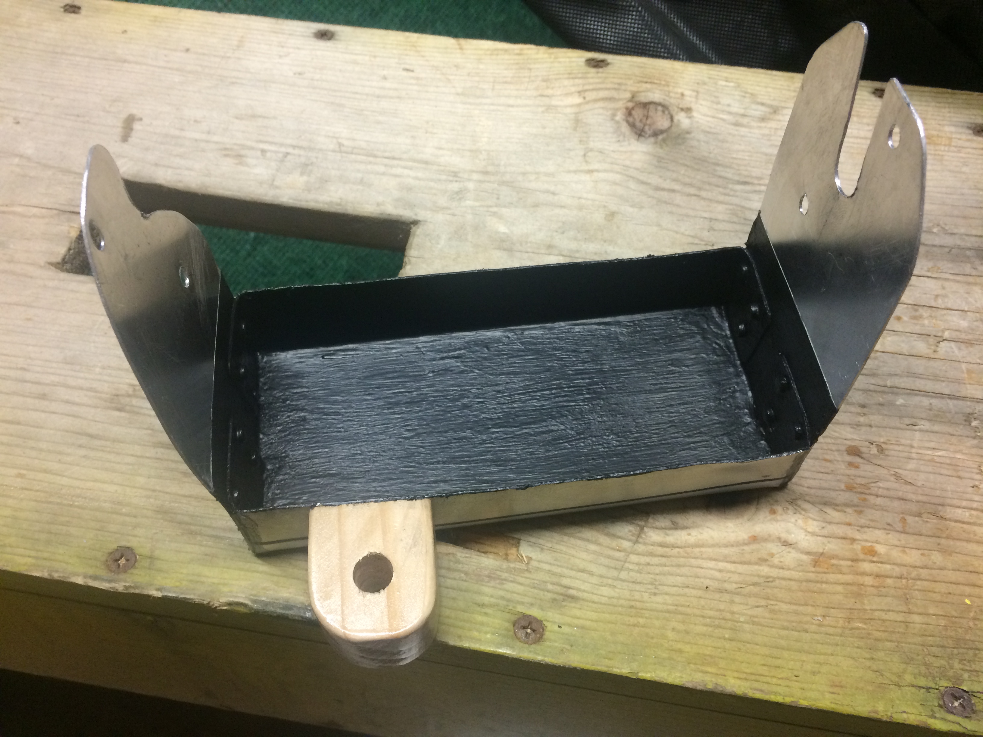

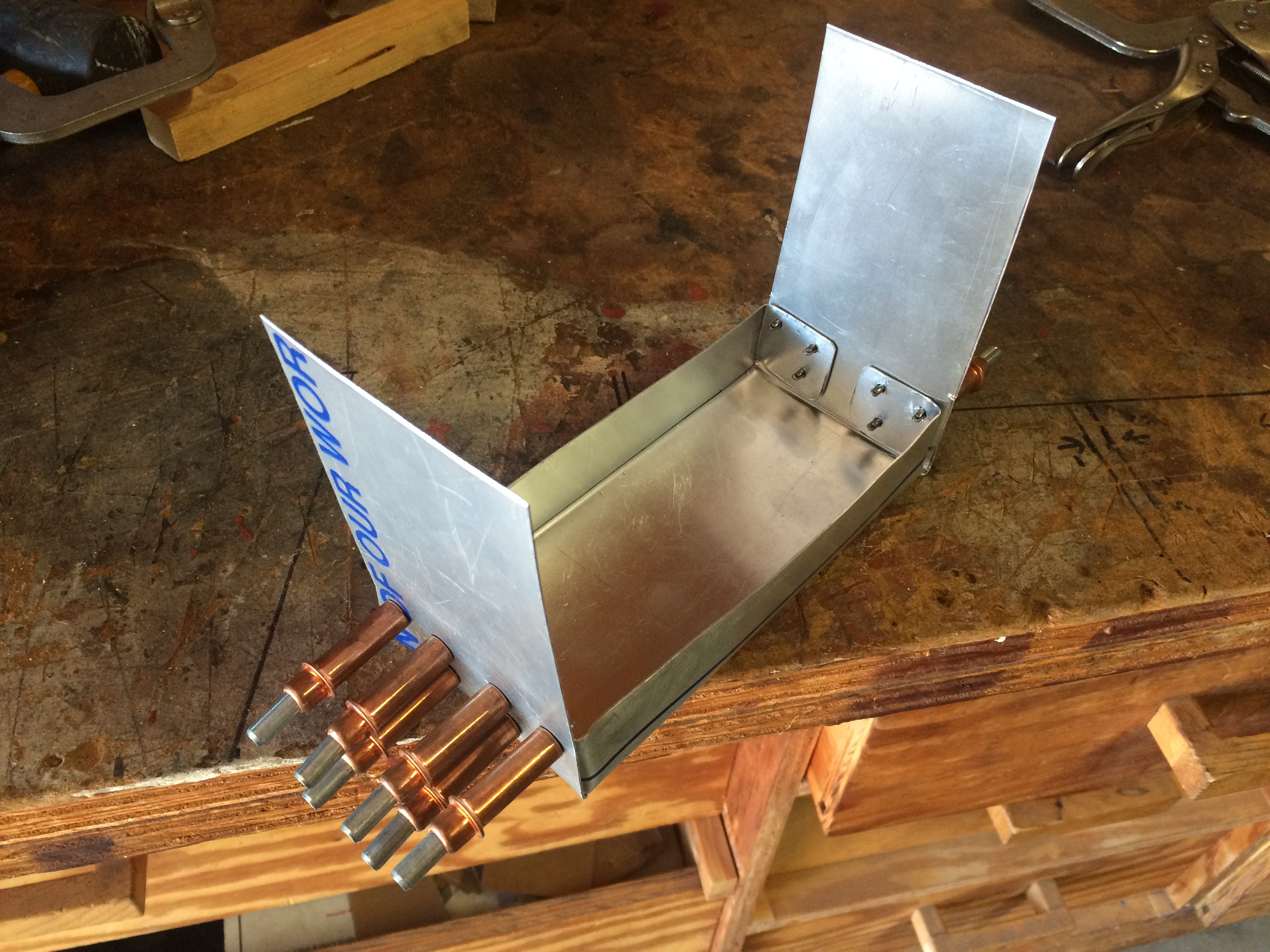

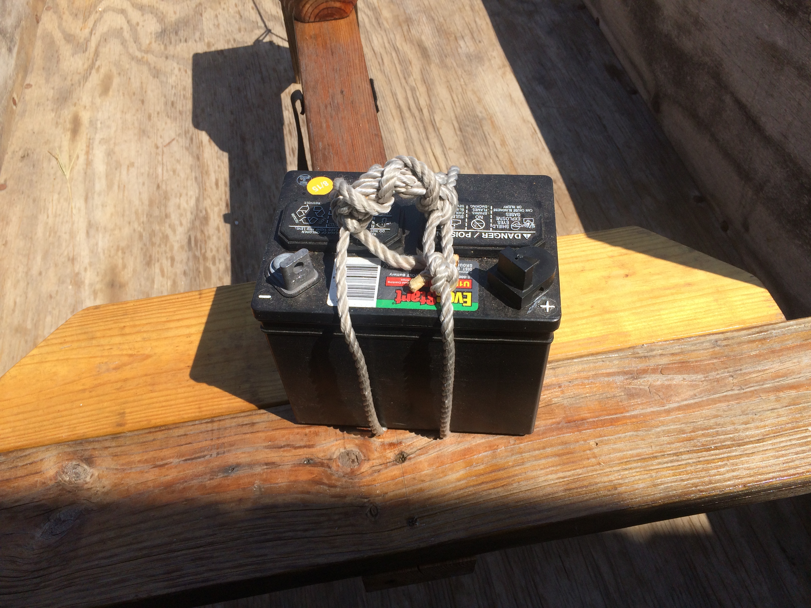

Now that I am active flying again it is time to mod my DynaTron Starter. I have been using a lawn mower battery for my starting needs. After seeing what some of the other pilots were using, I decided a mod was in order. First I made a cardboard pattern to determine size and shape. Then I cut a sheet of aluminum flat to size. I decided to rivet it together. Trial fit of batteries. Fit battery box to starter. So far so good. I thought I might have to move the starter to another location in my flight box. A trial fit in the flight box showed it could still fit where I keep it. No interference with my transmitter. This mod is coming along good for my needs.

Your work looks great, but personally I wouldn't have a metal battery box for my starter power supply. Too dangerous for me! Sullivan makes a neat molded plastic battery box, and metal attachment straps. It was designed for Nicads, or NIMS, but can be used with Lipo's. I bought the straps from Sullivan, and made my own plywood battery box. I use two 7.2volt (6 cell) RC car battery packs. I won't go back to a starter with a power cord. Self contained is the only way to go. When this pack dies, I'll probably change over to lipo's. Good luck with your aluminum battery box, and be sure to use some good insulation.

Greg you are correct. A metal battery box is not for everyone. Your safety concern is noted. I don't have a problem with this battery box. Giving it its due respect and following safe handling techniques is necessary. Sort of like starting a glow engine. Rest assured there will be no electrical fault with this box. I fear the 3 ft. cord attached to the starter more than I fear my battery box. Thanks.

ETpilot. I can see by your tools that you know what you are doing. That might not be true for the next guy who decides to make a metal battery box. Over the last 40 years I've known of two metal flight box incidents. One involved a metal glow fuel can explosion, the other was completed, and then abandoned. We agree that self contained is safer, and more convenient.

Insulation, insulation, insulation. Key to help keep things safe. Battery packs are insulated. So double insulation. This helps keep the operator safe. But, mishandling by the operator still can cause problems. A metal battery box is safe but, like all things, mishandling can cause unsafe situations.

When I see clecos I wonder if you ever built a full scale.

I have given thought toward building an RV-10. The time involved was too much for me. I have done some metal work on full scale aircraft. I am slowly weaning myself from general aviation. That is why I am back to flying RC.
