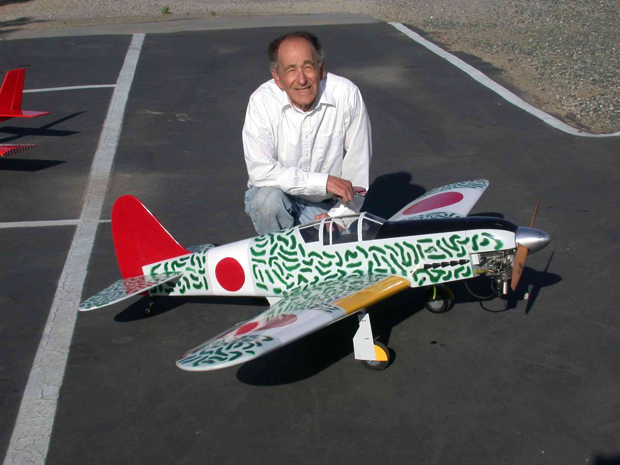

I use Sonic-Tronics 6 inch fiberglass tape (around 4oz) over lapped about about two to three inches at the dihedral joint. It's a foam wing sheeted with 3/32 balsa. The planes weigh 20 pounds and are 50cc powered. I've used this method on dozens of plane. Dan..

Good advice thanks Dan, is that a Miester or Anderson warbird scratch built ?

Scratch built from three views. Dan.
