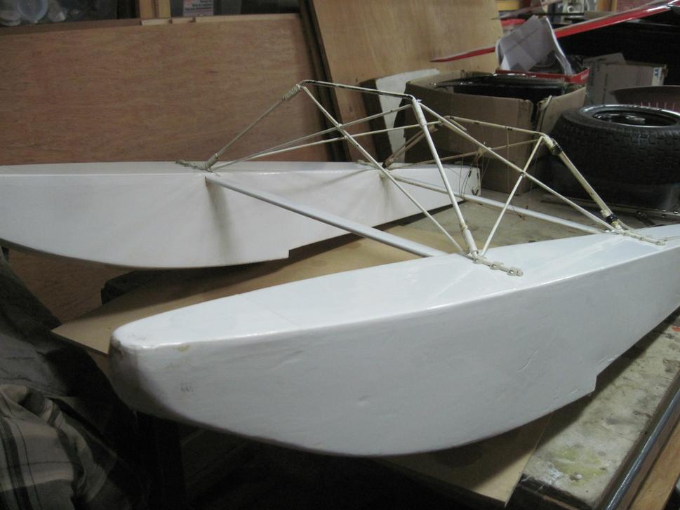

I am currently building a set of floats for my 9ft Taylor Craft. I built a set of floats for my Piper Cub last year but had some issues with cold solder joints. I soldered the frame for the Cub using propane and silver solder. We have a Tig welder at work and I thought I would bring the detatched part of the landing gear and have it Tig welded. Well, it did not quite go as planned. The wire is 3/16 in diameter and nearly melted in half! My friend who did the welding lowered the voltage but it really cooked the metal. I thought I might Tig weld the Tayloy Craft frame but after seeing this I quickly decided to go back to soldering. The problem is my soldering iron is only 60 watts, and I need at least 150. I was told that because my iron is so low wattage there was a greater chance for a cold solder joint. I soldered the frame for the cub using propane but found it very difficult to have consistant heat at just the right temperature. I watched a youtube vidio of someone soldering landing gear usind a 175w soldering iron which appeared to distribute heat in a much more efficiant manner. I have looked all over and where the heck can I get a 150w or better soldering iron?? I looked on the internet and did find some. I would like to deal in person, with a store, and not online. And one more question. What kind of paint can I use that would resist the corrosive affects of glowfuel. The cowel on my cub is starting to look terrible. Help with these matters will be greatly appreciated.
Left seat I use a micro torch that burns butane for all my soldering when using 2% silver bearing solder. If you copper wire wrap your joints the torch and solder will do a great job, I have a 150 watt iron that takes forever to heat and is a PITB to use. Some of those solder stations are suppose to work well for these things. Personally unless your going to do a lot of it it's a waste of money when a micro torch will do it all and it's not expensive.

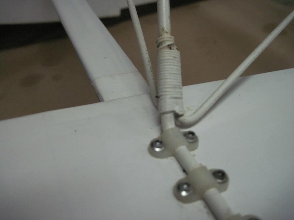

Hi left seat, I thought a picture of what I use to solder piano wire gear or mounts made from it would help.
Bernzomatic torch comes with a solder tip also, I use and enjoy mine a lot. Stay-Bright soldering kit will solder a lot of stuff and make a solid solder joint on brass & steel metals. I use Bernsomatic water soluble flux for it's easy water clean up after the solder joints are cooled, the liquid flux really works well and all flux is a corrosive so needs to be cleaned off as best as possible, steel will rust as well. Hot soapy water and a small wire brush will clean most of it off.
Some practice using this will go a long way, don't apply the solder until the metal is hot enough to melt it then remove the heat, allow to cool before handling your work.
Hope this helps

Soldering solid wire I wrap the wire together using 19 gauge steel mechanics wire. Sand the solid wire in the area to be joined then sand a length of the steel wire then wrap. The nice thing is that wrapping it with the steel wire will hold the whole thing in place and allow you to adjust everything before soldering. Don't leave it to long even overnight can start the oxidation process affecting the solder job. A few drops of acid flux and solder.
Its not so much the wattage of the soldering iron as the mass of the heated tip. An 80 watt is plenty for even 1/4 wire if the tip is large enough to hold the heat throughout the soldering job. A 200 watt soldering gun is a poor choice if the heat is wicked away once the solder begins to flow and the solder job ends up incomplete and results in a cold joint. First three pictures, first the two pieces of wire to be joined and the steel wire wrap and heavy duty soldering iron. Second the 1/4 inch wire and steel wrapping all sanded and ready to go. Third the joint wrapped ready for solder.
Last three are the float gear for my Piper Pawnee. Little lighter wire all around. You must size your wire to the job and make sure the solder tins the heavy wire not just the wire wrapping. The joint needs solder right through it.
