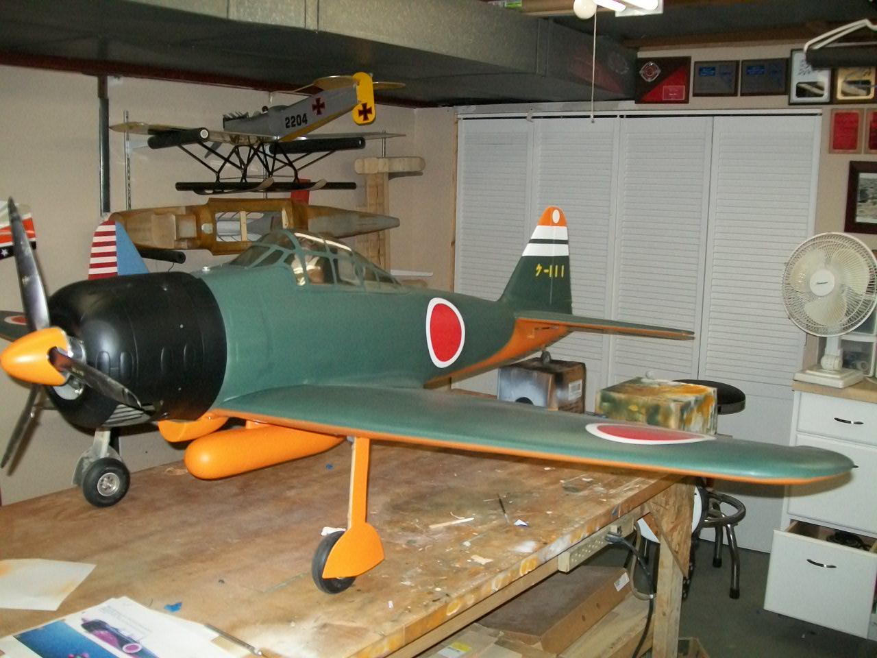

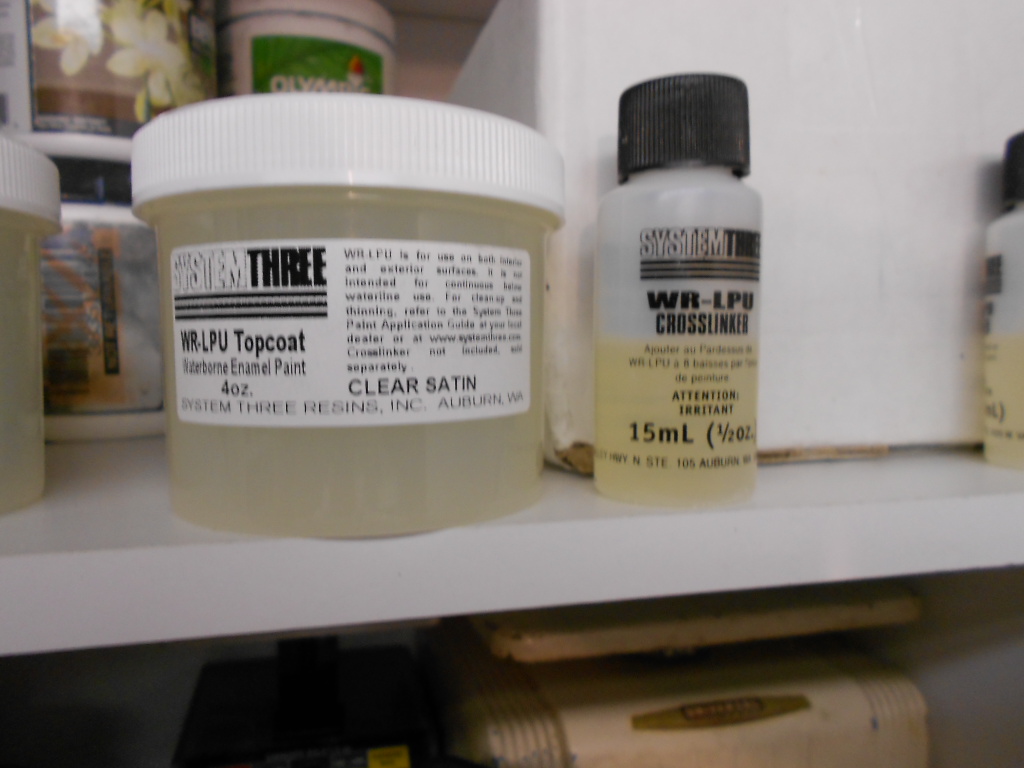

Originally Posted by xXsnipedoggyXx
I recently got my first put together foam RC plane, its EPO foam and I was told to use an airbrush and water-based paint, well anyways I figured out the paint rubs off easily with water, and in my case, I'm putting floats on my plane. so of course water is gonna splash onto the paint, and prob ruin it. now I'm getting a bit frustrated because the paint is soo delicate, I put the lowest tack painters tape and I even use the "stick it on pants" trick to get rid of tack, and it removes paint. is there some kind of clear coat or something I can put on the paint to stop it from rubbing away when the water touches it. I've finished most of the paint job by carefully using a clipboard to make edges and I'm planning on using a black decal sheet for the black borders, but ill still have a problem with the water.
I also just found out that the foam I have is safe to use aerosol can paint, so I'm a little frustrated right now because I thought I had to buy an airbrush ....
Thanks, any help will do.
I've sprayed this on a few planes through my airbrush,, come in gloss too
https://www.systemthree.com/products...ethane-topcoat
Any water based paint or clear Poly-U can be sprayed,, you just need to experiment to get the viscosity right for your spray tip,,, use the largest tip on your airbrush for water based paints and use mist coats to build it up slowly,, you try and put "wet coats" on and it will run
good luck
two examples
