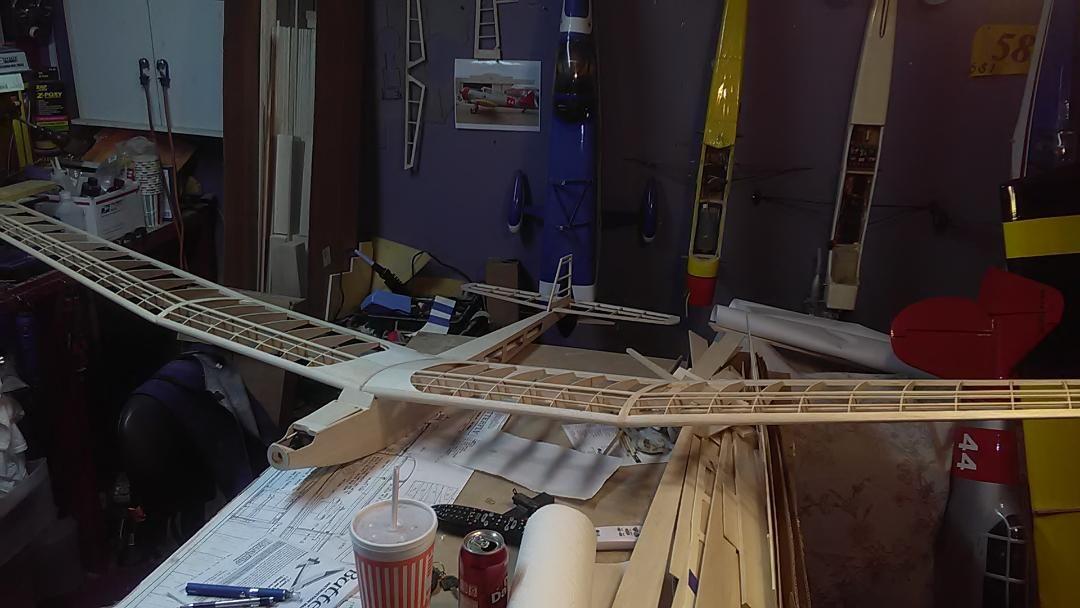

Framed plane ready for two coats of Clear Dope.
Wings doped and red trim applied. Sig Tennessee Red Dope. Wings ready for 2 coats of clear dope.
Fuselage painted with Sig Tennessee Red dope, and ready for two coats of clear which will be sprayed. The silk is a Dharma Trading dye yellow silk.
You need a 1.0 nozzle that you get with the Harbour Freight purple touch up gun. I have two of these guns, one for clear and one for colors. Thin the Sig Super Coat 1:1 and you will have the right mixture for spraying. These little guns known as HVLP (High Volume Low Pressure) guns don't take much air. Your maximum air pressure should be no more than 30 psi. If you can't get a good spray pattern with that, you need to thin your paint more. These are not called siphon guns. Go to your local Automotive Paint store and get a gallon of Medium speed Reducer. It is the same stuff as Dope Thinner. Clean your gun with lacquer thinner.
