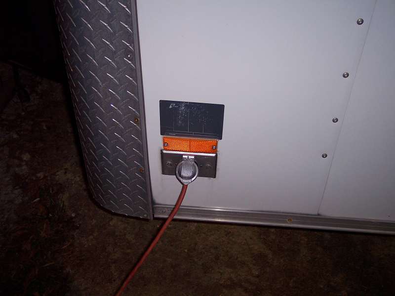

Check out your local Camping or Motor Home Sales and Supply! My Mobile Traveler has a A/C cord of about 25 or so feet to plug into either the campsite or at home in the driveway..
It exits through a small access door on the drivers side, which is weather proof and is lockable.
Including a picture of My Toys and on the side of the Motor Home just below the back side window and in front of the Sabre V65 Trunk is the A/C Hook Up Door.. Just inside below my couch/bed is the coil of wire that goes out the access.
Also at Home Depot a weather proof A/C cover and socket that would work, either 110 or 220 is available.

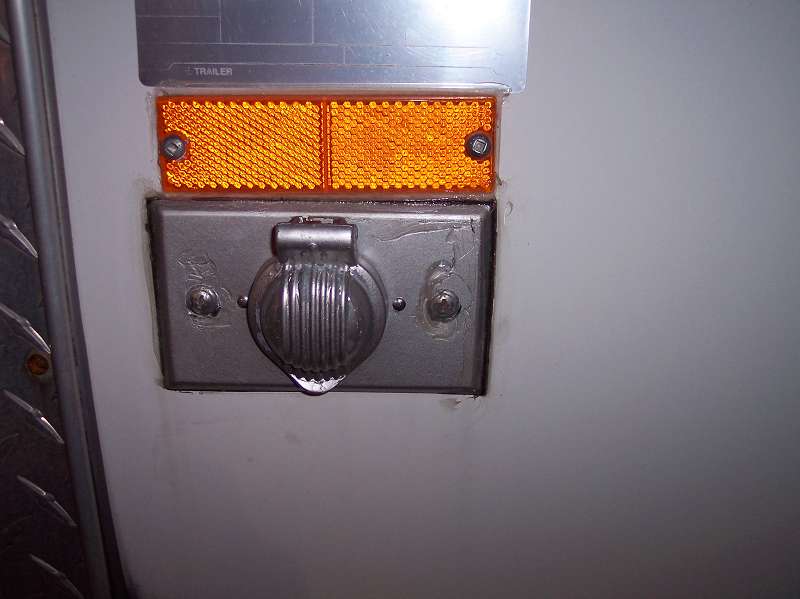

JohnVH ,
A couple of pics of my motor base cover so you can see what i described.
With this set up i just have to plug in an extension cord to the motor base (or generator cord for those
weekends at the flying field.

Thanks CK1, thats the plug cover I was looking at, but couldnt find the right connector like you have in it, maybe I didnt look hard enough. Will see if I can find it tomorrow!

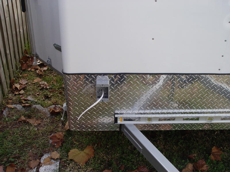

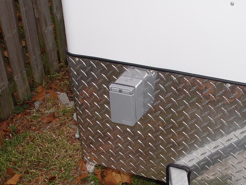

I went to Home Depot and bought this box. It's not flush mounted but doesn't look bad. I made a extension chord with two male connectors. Here is a link to my custom trailer job in progress. http://www.rcuniverse.com/forum/m_13..._3/key_/tm.htm

RCGUY,
The only problem with using 2 "Male" plugs on an extension cord is......
If someone was to accidentally knock the plug from the receptacle, you would have a LIVE exposed end laying on the ground......also, if you forget and plug the power side in first, there is a great potential for getting shocked. This is not a very good situation, especially if children are around.
There is a reason that the "Proper" electrical devices should be used.

RC Guy;
They call that a dead man's cord, there's a reason they call it that.

I searched two places today and couldnt find the male socket like in CK's pic, is this a super special thing?

John,
It's called a "Straight Blade Inlet" 120 volt, 3 wire grounding male recessed receptacle. Be sure the one you get has a weather proof cover and is NOT of the "Twist Lok" variety. If you explain to the counter person what you are doing, they will fix you up. I'm pretty sure the one above is made by Leviton. GE, Hubbell and Daniel Woodhead also manufacture them, the last two being VERY expensive.
Grainger carries them, any marine store outlet (West Marine comes to mind [will be expensive]) or an electrical supply house can get them if they don't have them in stock. I don't think Lowes or Home Depot would have them, as it is not a "big mover" item.
If for some reason you can't find it there, I would be glad to get you one and ship it to you. I deal with most of the larger electrical manufacturers hear in the East.[X(]
Hope this helps.................
