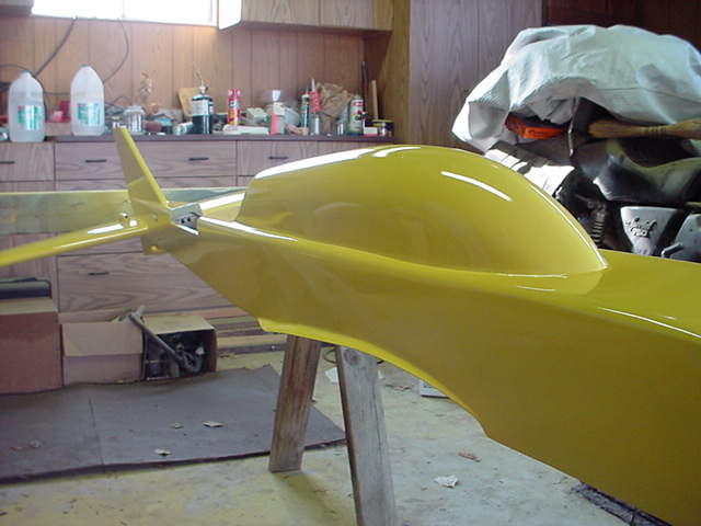

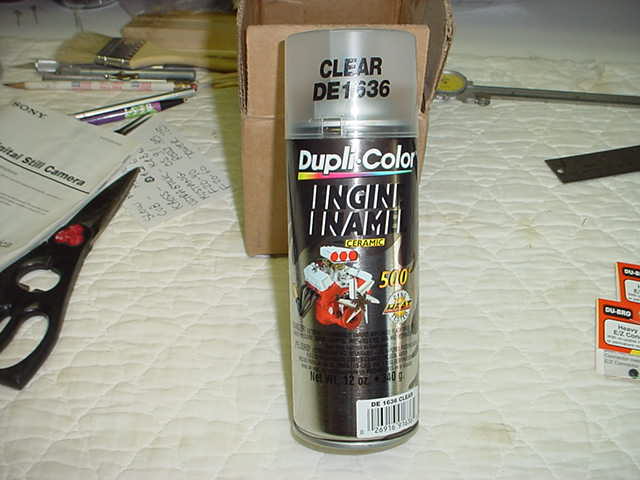

I just painted a plane with Auto-Zone..."Dupli-color" engine enamel....reason ? heat resistance, and gas-oil resistance.
I also used their "filler" primer.
I covered it with their "enamel-clearcoat".
Cost...I think it was $3.59 a can...about half the cost of "air-plane paint".
Result....?....I wont be using anything else...ever.

It looks great on a yellow plane. I wonder how it will look on a white plane. My only experience with "Clear" paint was several years ago, when I decided to paint a fuselage because I didn't want any covering seams. After doing tons of extra work to hide all of the wood grain and make it smooth as a babys butt, I painted it white, with red and blue trim, and then proceeded to ABSOLUTEY RUIN it with Black Baron "CLEAR" which should be called "Transparent Yellow".

Default Yellowing
Sorry to hear about that....too much work, just to see it ruined with the clear-coat.
Well...I won't be able to see any yellowing on this one, so I guess that question will remain open.
All i can say at this point...is the fuel residue came off with no trase of etching...whatsoever, using 15 % sport fuel. I am thinking about some good 'ol Turtle wax in a few weeks.
Here's the stuff I used...it's a "Clear Enamel"?????
