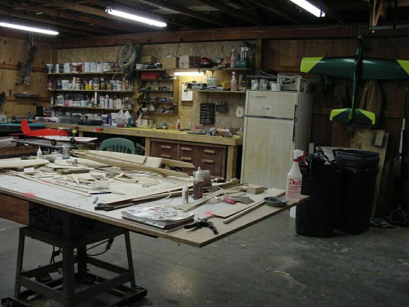

Be careful about building tables for your garage that will set in the middle. You may want to pull a car in there someday or somethin like that. I just set a sheet of particle board on my table saw. When I want to clear the garage for a different project I stand the board up along the wall ond roll my saw to the side.
Benches along the walls can be anything ya want.
In the pic you can see the carpet under the left corner of saw table. I have it placed under another small folding table in the back corner. I have a few smaller pieces that I move around when Im workin at the saw table they just weren't laying where you can see them when I took the pic.

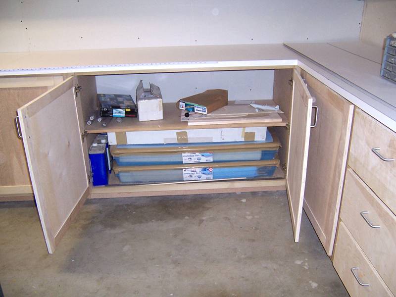

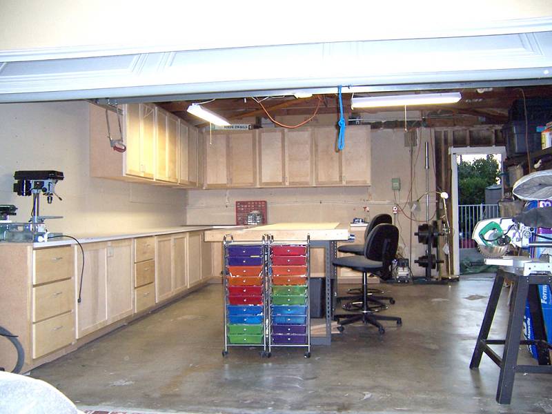

I am just completing a workshop conversion of my garage. I built my own cabinets so they would be long enough to hold kits pplus building cabinets is something I've been wanting to try. I build my main buildboard as an island. It's 4' x 8' steel topped to build using magnets instead of pushpins. Be sure to have plenty of lighting. I currently have 4 floro shop lights and may add a 5th. Here's a recent photo, but I have done more work since this photo. I'll take another photo and post this week.
Scott
Scott
Lee, aimmaintenance and Scott -
Those qualify as hangars - they left garage status behind some time ago
My spare bedroom building space would just about fit in one corner...
Cheers!
Jim
Cheers!
Jim
