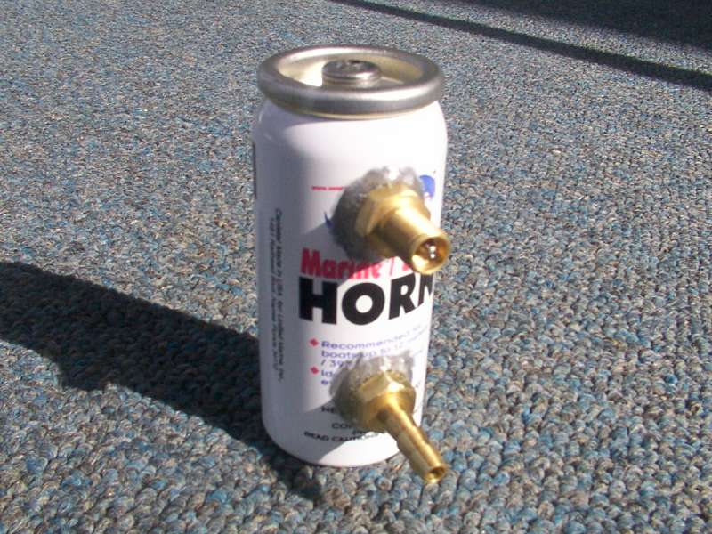

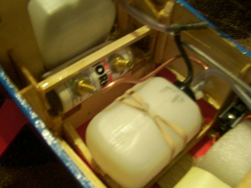

Okay you don't laugh at my set up here but wanted to post because it works. I used parts I got from a hardware store and a few things I had extra laying around. I figured since I like to tinker around this would be fun to do.
My smoke system works of compressed air instead of electric motors and batteries. I been wanting to add smoke to my Edge and figured I would make up something to see if it worked. I looked at the kits with motors and all and they just seemed a bit heavy to me then you still have to add the batteries. I heard a few people talking about putting a tap in the crankcase for pressure but did'nt want to do that on my new Saito.
What I did was went to K-mart and bought one of those small handheld air horns. I used that as an air tank because it was small and light. I drilled 2 holes, one for air fill which is just a air valve kind of like ones you see on bicycles. That way I could hook up a pump directly onto the tank. The other hole was a nipple that I used to run air to the oil tank. I soldered copper tubing to that nipple and ran it right into the 6 oz tank I have.
On my oil tank I have 3 lines going into it. One is the line for air, the other is the oil feed line that has the clunk on it. And the last one is vent line to allow air to bleed out as I fill the tank with oil. The oil line runs to a small needle valve I to regulate the oil flow and then into a fitting in the muffler I tapped in.
At the moment I don't have an on or off valve for the tank but intend to use one when I find one. I was looking on the ROBART website and they have what I need to make it work right. The way I control the oil flow is by pumping my air tank and then it pumps the fuel tank. I have a servo that runs a wire around the fuel line that kinks it off and on and that is what cuts my air on or off as well as my oil. I know this is not the best way but I just made this up as I went along and learning about how it works at same time. All I need is that cut off from ROBART and it should work pretty good.
Anyways I wanted to see if my set up would work on the way I have it now and see if I was going in right direction. I filled my oil tank up then cranked the engine. I am running a Saito 100 so all I needed was the oil to go into muffler and it would heat from there since supposedly 4 strokes exhaust is hotter. From what I have heard. Anyhow I cranked the engine up let it warm up then cut on my oil. It took about 5 seconds but then my smoke started. I adjusted the needle valve until I had the thickest smoke. I noticed if I turn the needle way open it wouldn't make it smoke any thicker so I have it set just as it looks like it has best flow. I was able to cut the smoke on or off and it worked good. With my small air tank I was afraid that the air would run out before the oil but it didn't. I was able to run all my oil out and still have pressure left over. I only got about 2 1/2 to 3 minutes of smoke off my 6 oz tank. I will get a larger tank to allow long smoke runs since this one works good so far. I just wanted to see if it would work at all and so far it seems like it does.
I have not flown it yet so not sure how the smoke will look in air but on ground it was pretty thick and covered up my yard. I seen where some people are making their own blend of smoke oil and thought about trying it later on. But for now I bought a jug of SUPER DRI so I would know the oil I was using would work. I didn't want to be trying to make smoke system and making up a blend at same time.
Here are some pictures on what I have now. I plan on making it much better but this is a start that hardly cost me anything. The oil was the most expensive part out of all of it. I know it looks chessy but it works!!.

Geistware , I missed out on the Griffin fun-fly. I have the flier in my car and was going to go but figured it wouldn't be much of a turn out with our nasty winds here. I ended up working on planes instead, a least got a lot done.
I haven't had a chance to try in air yet. Hoping that I will get a chance tomorrow if wind is not gusting million mph. If not I want to try out my smoke at least on ground in day time to see how it looks like. I took some pictures of it when I got it done but it was nite time. You could see smoke but only in spots. I will take some tomorrow.
Also does anyone know how many oz per minute is normal? Like what is expected out of certain tank sizes? I am trying to get an idea so I know which way to go with mine.

I got those parts from a hardware store here. They have just about anything you can think of. But one thing is those brass fittings are pretty heavy. But that is all I knew to use for my idea.
I drilled a hole in and smaller than the brass fittings. Then I just used epoxy around the threads and screwed it in place. Its hard as a rock now and don't seem like it would move. I have no clue how much pressure it can take max. Like I said I just made this up out of my head. I been pumping 30-35 lbs in that small tank. I have a gauge on my pump that I use. I found anything lower than that did not work to well.
I would like to make another tank and put the fittings used from ROBART on it. Also use high pressure lines with it. Then all I would need is one tap in my tank instead of 2. I could use some T's and then the valve and should be good to go. I also looked at the air tanks they have but there kind of big to squeeze in my plane.

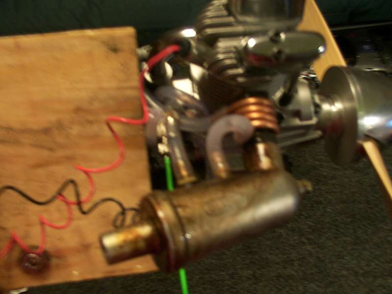

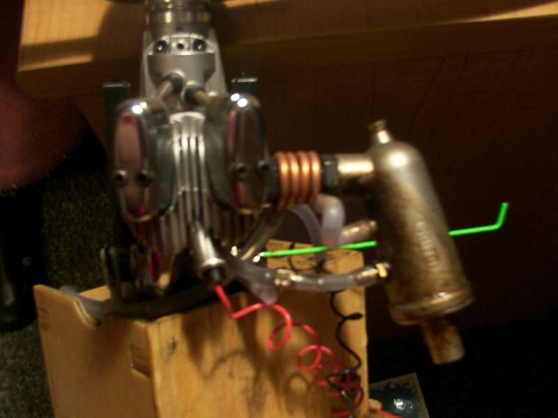

I just got done trying out the copper tub wrapped around the header to preheat the oil. I did not yet tap my header I just wanted to see what difference the copper made compared to not using it.
When I tried it it made a huge difference in the thickness of the smoke. It was very thick starting from muffler and back. Before it was puffy and in patches and more noticeable behind the plane. Now It is very obvious it has smoke. I had a nice thick trail of smoke coming out now. The only thing is my little home made air tank sprang a leak and I would immediately loose pressure and the smoke would stop. The air tank idea did work but I need a better way to hold those fittings in the can. Also I haven't been to hobby shop yet to grab those high pressure lines. I had problems with my lines ballooning and popping off.

I am going to try again because the air pressure idea works. I just need the right parts to make it work and not come apart. It sure looked cool when all that smoke poured out the muffler.
Since I didn't have a valve for my tank it was set up direct just to see if it would work. By looking at my Gage on my air electric air pump by turnning on or off it took barely a 2 pounds to get it to smoke and with my needle valve set at 3 1/4 turns open. The needle valve I used was from a .15 size buggy engine.
avistar181 What I meant by preheating was by using the coil copper tubing and wrapping around my header. I did not solder into the muffler because this was my first time trying this out. I simply wrapped around and connected to muffler with a short piece of fuel tubing. Here is a picture I took

Thanks for the pictures, they really helpme understand what you meant by preheating the smoke oil. I havent quite gotten enough time to mess wiht the idea yet but i caint wait. I figure if I keep cheking on this thread, you guys will have the set-up all tested out so i wont have to screw up an go back to fix things. You will already have done that!! J/k Thanks though for your help in describing what you have done. Its such a cool idea! Keep the updates coming

A word of advice when it comes to pre-heating... Wrap the engine cylinder, not the muffler or header. By stealing heat from the muffler, you're taking heat from the very place you need it the most.
