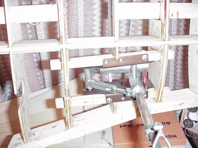

here is a pic of the tail wheel retract I built. Research tells me that the Mustangs tail wheel retracts more up than forward. The retracts I bought from Robart and Century swing back and up in an arch and neither would work without cutting into the bulkhead. I had already built the tail wheel doors.
