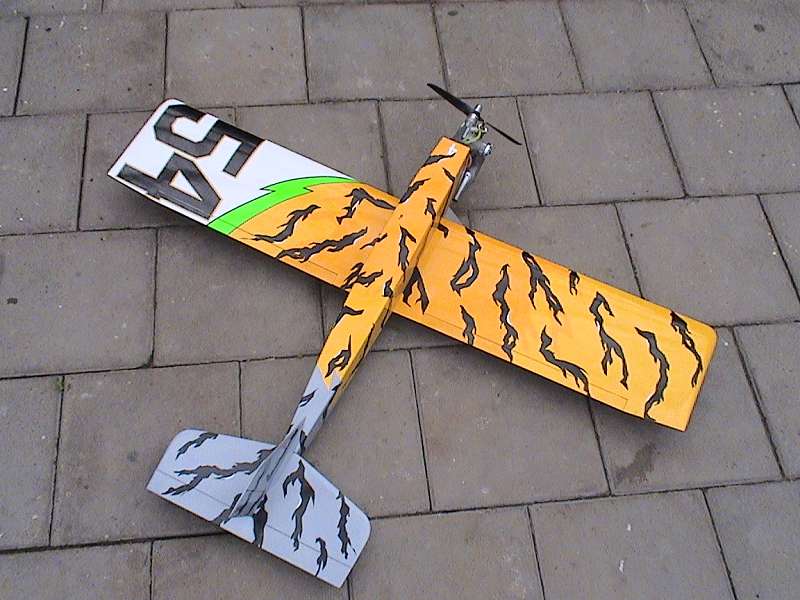

Quick question...I'm covering a model with monokote that is part balsa and part fiber glass. I'm wondering if I can use coverites quick stik or balsa rite, etc on the solid glassed surface and just apply my monokote accordingly? I thought about using trim sheets but it is more difficult to get toconform to the compound curves. If i have to I'll cover up to the f/g with monokote, and paint the rest, but as I want to do a multiple color sheme I would rather the entire area look seemless in one type of finish. Any thoughts?

If you had used Oracover (Ultracoat in the US) you would have had no problem what so ever.
Monokote is a little bit harder to get to stick to fiberglass though.
Never ever use Balsarite or any of that stuff on a fiberglassed surface or over any other surface for that matter...it isn't necessary.... just sand the surface smooth and apply the filmcovering.
