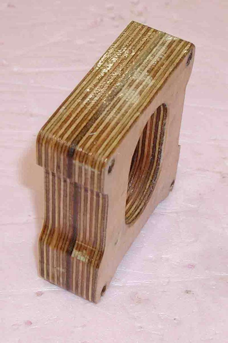

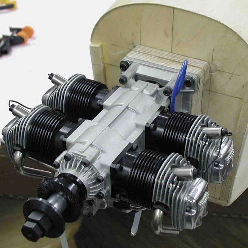

Like so . . . except this spacer is 1".
ID:	194269   Click image for larger version
