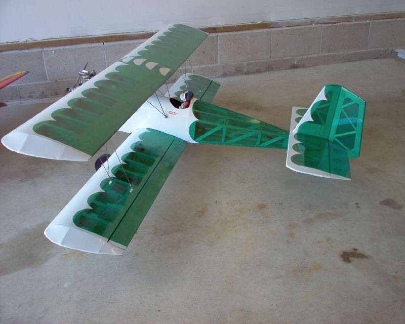

I'm looking for some instructions or a website showing in some detail how to make scalloped Monokote finishes like on a Gee Bee. Any help is appreciated!

Here are a few pics from my scractch built Lazy Ace..Is this what you mean?

I used a coffe can one time to make the scalops, I drew a line on the monokote,approx 6-8" away from where the LE would be, then would put half the coffecan on that line and draw around it with a felt tip pin, then cut out free hand.

You can use just about anything to draw a circle to get that design. A good point is to turn your monokote over and draw on the backing, and then cut your design out. Another option is to go to the sewing department of Wal-mart. the sell a circle cutter there. It's a large wheel with holes in it. You get a blade tool that will fit into the holes to cut your circle with.

That is just what I needed. Do you prefer to iron over the trim or use Monokote solvent?
