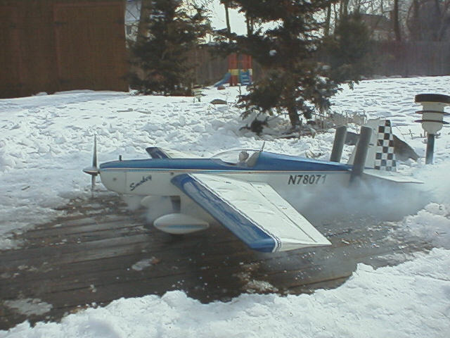

Two Cycle Smoke System
Been working on this smoke thing for the past few months. Got it resolved using a .40 engine and got very impressive smoke. Kept the weight to an absolute minimum also.
The whole process can be seen here:
http://www.rcuniverse.com/showthread...r=2&forumid=58
The attached photo shows the results.
Bob J..
