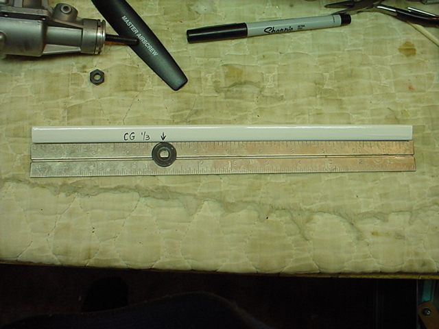

RC-FIEND....picture it this way....(pic #1 ) the c/g is at 4"....the balance
or "fulcrum point". If you move the balance ( or fulcrum point ) back....
like in pic #2, the plane gets real nose heavy. That's why in order to move
the balance point ( c/g ) rearward....weight has to be added to the rear of
the plane.
I know....without visualizing it, like I have done for you....it sounds backwards.
Don't worry, I used to think of it that way as well.
Dave.

Bax, If the manufacturers go through such rigorous testing why not just include in the instruction where and and how they had the equipment installed when the found the perfect flying CG?
Flyboy look what I got
If I stay in your tracks I will be well on my way to being an official RC pilot [sm=idea.gif]
