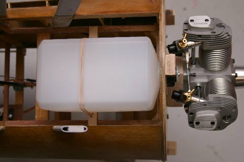

Here's how I do it on all the planes I build. I run the tank stopper assembly through the firewall. This will allow easy access to all the fuel fittings and keeps the fuel lines from kinking. I never ever use slant tanks or any other type of tank that you have to have the fuel tubings hidden in the fuselage. I center the fuel stopper with the carb, and after everything is hooked up I use a liitle clear silicone to seal everything up with.
Here's some pics of the tank setup on my Nieuport 28 (I hopeI can get them to load)
