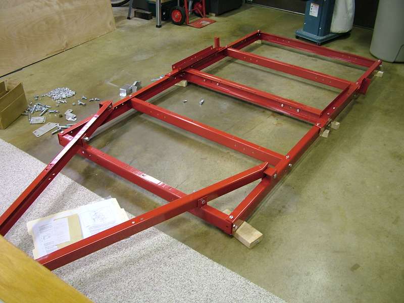

First step a trip to Harbor Frieght and a trailer kit pn/90154.
Unpack the two boxes and take inventory. One damaged part but a quick trip back to HF and a no qustions asked replacement. I love no hassle customer service!
This trailer has a folding option that lets the trailer fold in half for storage. With a box bolted to the trialer frame this option is not usable. My plan is to eliminate the folding option and parts used for that.
Assembly begins. This kit is a bolt together kit and requirres only a couple of wrenches to assemble. I have decided to bolt together the two center cross members where the frame halves would fold for storage of the trailer. This was simple and easy to do as all of the frame members have ample holes in them. I have planty of extra hardware for this step since I will not be using the stake holders or the folding option. I assembled the entire frame less axle and wheels with all bolts just hand tight. I then realized that the plywood for the trailer floor would provide an easy template to make sure the trailer frame bolted together squarley. Off to the hardware total cost at this point $264.99

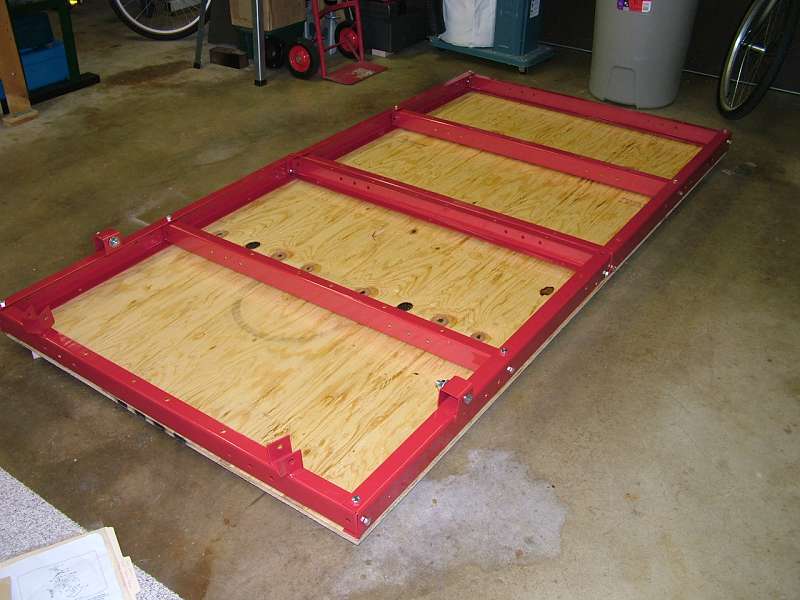

After a succesful trip to one of my favorite stores (hardwares) I now have one sheet of 19/32 4 ply underlayment plywood for the floor of the trailer and 2 sheets of 5.2mm luan plywood for the sides and 4 1x2"x8' top choice pine bords for fraiming the box of the trailer. Cost of trip to hardware $ 44.80.
19/32 plywood on floor with 2x4 blocks to space it off the garage, err I mean Trailer Manufacturing Facility assembly floor, and the same trailer frame placed on the ply for assembly. This time I tighened the bolts to hold the frame together and started to assemble the nose (trailer hitch of frame) using the instruction assembly manual that came with the trailer.
I also have manufactured (2) aluminum straps (1.5x9x1/4") brackets to replace the folding hinge brackets suppled to couple the front and rear of the folding trailer. This was just something extra I did because I have the aluminum on hand, you could still use the kit supplied brackets and they will work just fine.
After the trailer frame is assembled completely I will seal the plywood floor using latex primer and finish paint. I will detail what I do when the time comes. Now back to construction, more later.
Total Cost (running total) $ 309.79

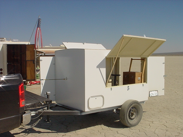

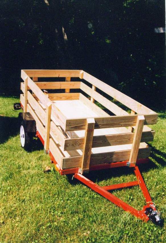

Here's how I built my trailer using the same Harbor Freight base as yours.
I use a custom made vinyl cover to keep the rain out.
It's 4' by 8' outside dimensions.

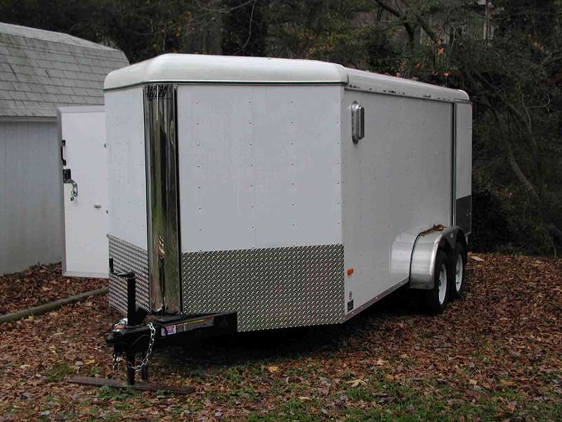

Couple of things to ponder . . .
Trailers are more than mere toy toters, they are also toy _storage spaces_.
If you enclose the majority of the "A" frame section, you increase the volume of the dry storage area and also reduce the amount of power needed to pull the thing down the road.
Whether you make your trailer a "V" nose or not, add a rock shield across the front - 24" wide 1/8" aluminum plate would serve nicely.
Photo is my store-bought "V" nose 7'X16' tandem axle model airplane hauler.
My model airplane hauler _puller_ is a 2003 E-350 Extended Super Duty van with the three rear bench seats removed and stored. Makes room for a full 4'X8' sheet of half inch ply in the back, and I can haul a _lot_ of stuff in the van.

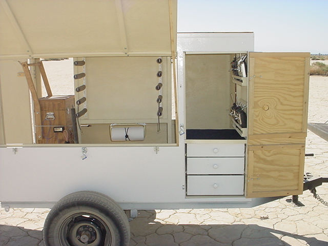

One of our club membersmade his hauler from a pop-up camper that the canvas had rotted in. He gutted it, made tie-downs for everything. It had a crank-up fiberglass top, and was about 8 x 12 and about 3 feet deep. He could get three 1/4 scale biplanes and all his flight gear in it. Gave about $250 for the camper, even had a spare. With the low profile, he said you hardly knew it was behind you, no wind resistance.
I'm gonna try to find something like that, with diesel going past $2.45/gal and me getting about 13-14 mpg. The only thing covered I have to haul planes in is sort of a multipurpose affair. We camp in it, haul horses in it, haul airplanes in it, you name it.Here it is:

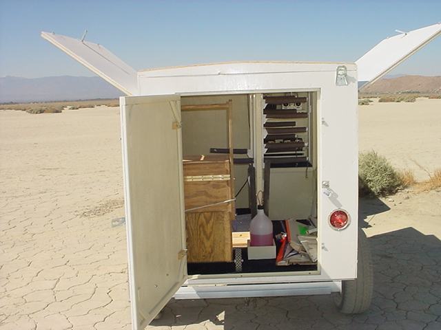

I wanted to show you some pics of a neat "reach-in" trailer I saw, different
from a "walk-in" trailer....I need to find them.
Dave.

FBD,
Nice trailer with lots of doors to reach things through. Not sure how I will build the box yet but all of these pictures gives me plenty of usable ideas. I realy like the simplicity of a pop up lid with a hinge along one side though. Solves the problem of getting a door to seal all of the elements out.

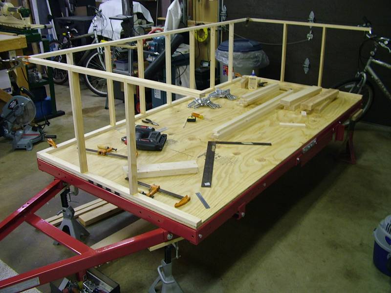

More progress on my trailer. A trip to the hardware for more wood to frame the sides with. Once the frame (1x2" pine) is completed then the 1/4" luan plywood will be atatched and then the top will be fabricated. All the wood is being glued together using Tightbond 2. I decided to use Tightbond instead of the Gorrila glue. Much less expensive and I do not have to continualy wipe the excess glue away. The polyurethane glues such as Gorrila glue expand and foam a bunch.
The lower box portion of the trailer should be completed by the weekend and then next week on to the top. I have a camp over for the youth at church this weekend so my schedule may take a major detour.
Total cost of wood from hardware $ 48.23. This includes a new carbide tiped blade for my miter saw.
Total cost of construction to date $ 358.02

Joined: Aug 2004
Posts: 1,390
From: East Cobb County,
GA
ORIGINAL: bps
Right now it looks a lot like the stud frame walls in a house, and you know what high winds can do to houses . . .

i like the progress. this is what i am planning on doing eventually. it would do you good to treat it like framing a house do some crossbracing even if not for finished strength but strength as your building it.

I just finished hanging the airplanes from the ceiling and putting them up on shelfs. Behind the camera is a 16 foot long by 4 feet wide building table with a couple of projects on the table. I built this table when I was constructing some full scale experimental planes. It has served me well.
Thanks for the comments on cross bracing, I will study on that. Remember though that the frame will get 1/4 plywood glued to it all the way around. My thinking here is that the ply becomes sheer weebing and takes most all of the tension and sheer loads. Also this is not a very large trailer and has no doors or windows.
I have got to get this thing finished so that I can get some more flying in this year. I am spending way to much time in this garage.
Keep the coments and opinions coming, thanks for all the response.
