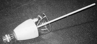

Ok, kill me now. I couldn't find the URL for the article, but here is the text and the more important pictures.
How to Articles Index Make A Pop Bottle Cowl
Its easy, inexpensive and environment friendly!
By JOE BESHAR
I NEEDED TO MAKE a thin cowl, and carving one out of balsa just wasnt practical. A modeler friend suggested that I pull one out of a clear plastic soda bottle. This sounded interesting, so I found a few clear bottles in the recycling bin and developed this simple, inexpensive procedure to make a very satisfactory cowl.
1.
Make a plug of the cowl out of balsa, hardwood, plaster of Paris, etc.
2.
Use a clear plastic soda bottle into which the plug will fit as tightly as possible.
3.
Cut off the bottom of the bottle and remove the cap. Insert a long dowel into the bottom of the plug.
4.
Put the plug inside the bottle. Direct a heat gun at the bottle while you turn the assembly.
5.
The plastic has shrunk tightly against the mold plug. After it has cooled, trim the plastic and slide it off the mold.
6.
Paint the inside of the cowl with plastic-friendly paint and, if you like, add a decal or two to the outside.
You can also use this procedure to make canopies and other model accessories out of plastic bottles. Good luck and happy landings! j

The plastic should be folded over the bottom of the plug and stapled on before heating.
The top can be screwed back on and a hole put in it to use compressed air for removing it from the plug.
Top-Flight paint is too tranparent and you can see right thru to the underlying color of the bottle so use clear bottles if possible otherwise paint with Rustoleum.
Contrary to a previous post about being flimsy I find them very tough and resilient just like the pop bottles they come from.

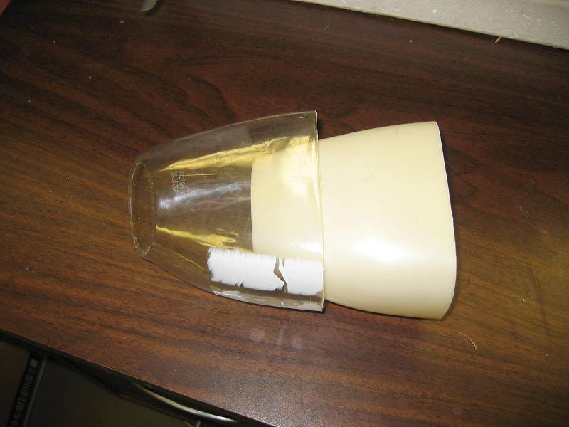

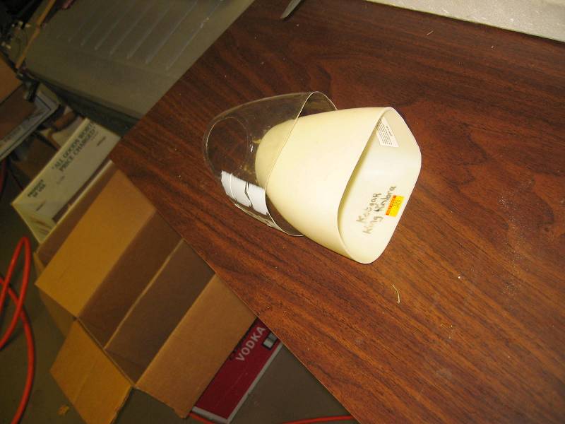

Default RE: How to make a home made plastic cowl
Great method. Use another cowl as the plug.
I had a Kougar/King Cobra cowl that had not been cut (afraid I would mess it up). The cowl slipped inside of the coke bottle and inside of ten minutes I had a new plastic cowl for experimentation. Forgot the Vaseline. Now if the original cowl will come out. But if it will not come out I have not lost anything but an empty coke bottle.
What a nice solution.
Wow! Ten minutes of effort.
Bill
