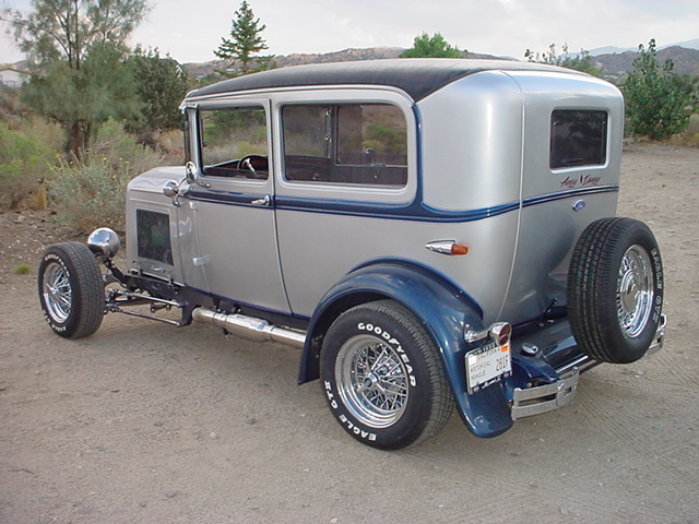

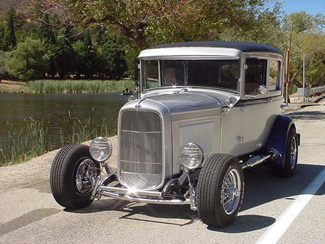

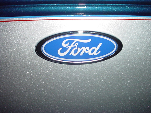

Well....I don't know about that. I painted the blue on my hot rod with a Harbor
Freight $15.00 detail gun. It comes down to thinning the paint correctly, adjusting
the gun correctly, and the operators technique applying the paint.

Old 12-21-2005 | 08:33 PM
Posts: 4,305
Received 9 Likes on 9 Posts
From: Brockton, MA
Default RE: The perfect spray gun.
Nice ride, Flyboy...
Does she have a sister?
Beautiful rod. Would love one of my own someday.
Bob

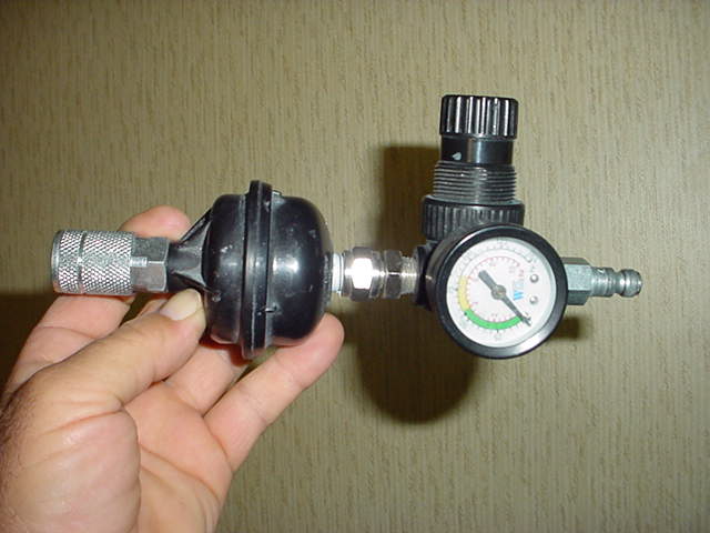

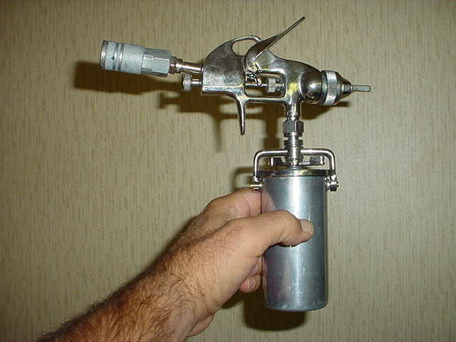

I really did paint it with this inexpensive gun, the round water trap, and the little
regulator was another 10 bucks.
FBD.

I have a question about filters to use when spraying latex paint. Do I need to have a filter in the air line? There are several options out there and I don't know the best option to go with. I also don't want to spend more than what is needed on a filter. Here are some of the options I have been looking at:
OIL/WATER SEPARATOR http://www.harborfreight.com/cpi/cta...emnumber=43764
HUSKY 1/4 In. Air Compressor Filter http://www.homedepot.com/prel80/HDUS....jsp?pn=169654
AIR FILTER/REGULATOR UNIT http://www.harborfreight.com/cpi/cta...temnumber=1118
AIR FILTER/REGULATOR http://www.harborfreight.com/cpi/cta...emnumber=42035
125 PSI FRL AIR REGULATOR http://www.harborfreight.com/cpi/cta...emnumber=45009
Obviously with the FRL units I would not put oil in them.
What do you guys use/recommend?

The answer is yes, you always need a filter/trap in line when you are spray
painting. This small round one from Harbor Freight is the smallest, cheapest
one on the market....around 5 bucks.
FBD.
