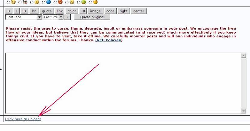

Bill, I'd love to send you a photo or two of my latex finished Camel, but I can't solve the mystery of how to do so on this site. If you or a lurking moderator or anybody can explain it to me, I"ll make a fourth try.

Click Post Reply instead of using the Fast Reply box. You'll see a button that says upload. Click it, find your image and submit it.

ORIGINAL: Walt Thyng ". . . . can't solve the mystery of how to do so on this site. If you or a lurking moderator or anybody can explain it to me, I"ll make a fourth try. . . . "
Step 1: Click on Reply
Step 2: Type your message.
Step 3: Click on "Click here to upload! I believe there is a size limit, so your photo should be JPG and no more than 50 - 60K. Not positive about the specific size rules though. But Steps 1 - 3 work for me.

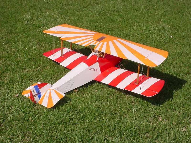

Okay, I'm giving it a try.

I tried posting the photos so many times, I forgot what I had written. My Camel was finished in Krylon Kids colors latex from Walmart. I added floetrol to smooth the finish and thinned with summer formula windshield washer fluid at about 1-4. My spray gun was an automotive detail gun bought from Home Depot. Air source was a Sears diaphram (sp?) type set at 40 lbs.
For what it's worth the covering material was Walmart polyester dress lining sealed with two coats of nitrate dope and two coats of Aerogloss dope. The whole system gave a very scale-like WWI finish.
Walt

Thats a nice looking plane Walt. I've seen the Krylon Kids colors latex at several different location but was unsure how it would look. Did you use a clear coat after painting? I wonder how well automotive clear would look over latex.

W.M No clear coat as I fly elecric and it is a WI warbird.
