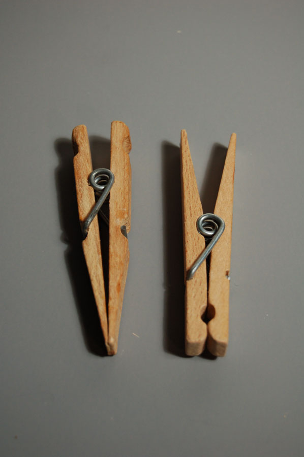

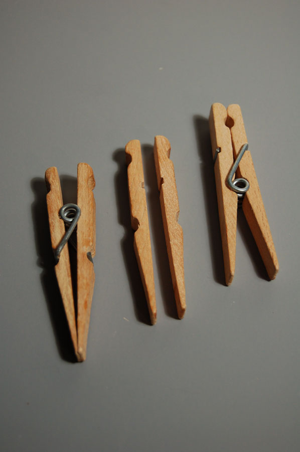

There are many things to buy in our hobby that will make a big dent in your wallet as well as straining domestic relations. But when I bought my first RC kit years ago the dealer showed me how to reverse the halves of a wooden spring clothes pin to give it a longer reach. You just remove the spring, shift the wooden pins back-to-back, turn the spring around and reassemble it. The only problem these days is that it is getting hard to find quality wooden pins.

excellent tip, but be careful... clothes pins can be quite strong, so they can actually dent softer woods.....
i have used them and glued a lat piece of ply on the end to spread the pressure out a bit.....

I have an old airplane building book that describes the use of clothespins-it shows a bunch of variations, reversing the sides and etc, but also shows some with added extensions using popcycle sticks, straight away as extentions, right angle, 45 angle, all sorts of specialty applications. Those were the days when you made do with what was at hand. They work as well or better than a basket full of spring clamps.

I was taught this tip by my father(old school of ambroid[:'(])lol. The other thing was to epoxy a piece of scrap thin ply out at the ends to make them wider and less prone to indent areas of balsa you are clamping
