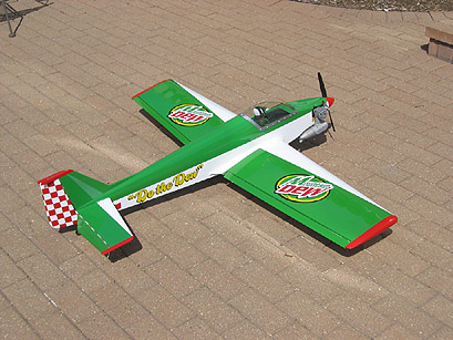

I'm not sure if this is exactly what you're looking for. This is one of my latest, I did a checkerboard on the bottom of the wing. I used Adobe Illustrator and was able to envelope a checkerboard I laid out. You can also use Corel Draw. It's generally a lot cheaper if you search out a version that's a couple of revs behind like version 9 or 10. You can get pretty radical, I actually abandoned some of my earlier checks because they were a little too busy. The checks, logos, and lettering are all Monokote.

Thanks - I think this is more like it - Using Illustrator, exactly how did you go about getting the checks you wanted.
TIA
..AJ
Old 04-07-2006 | 08:42 AM
Posts: 284
From: Batavia, IL
Default RE: Need help - Warping Checkerboard
Well I basically started by drawing a triangle and cutting into pieces until it was a triangle shaped checkerboard. Then I used the built in envelope tools to twist into shape. That one was a simple curve shape but you can do one that looks like a waving flag or even a fisheye shape. Illustrator is a bit pricey, like I said Corel may be a better choice for occasional use and it's had the envelope capabilities built in forever. The price is more reasonable too.
