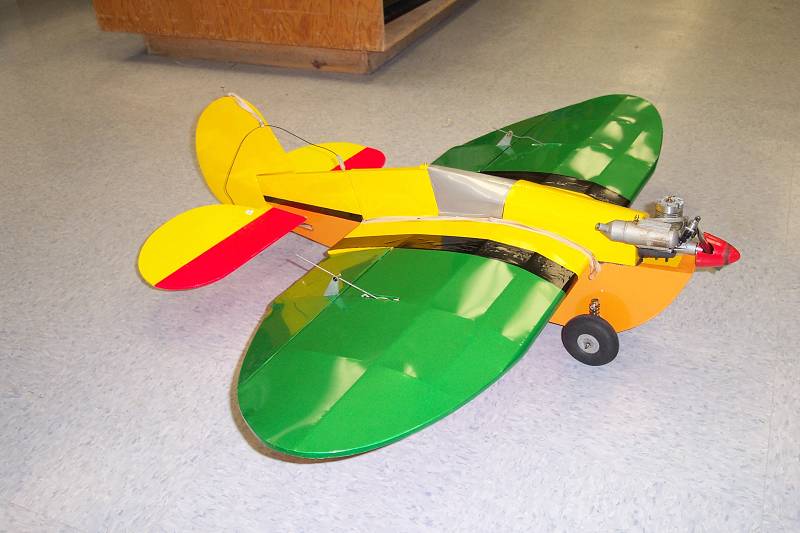

This is the way I did mine. The airplane is 4.5#; we are flying off of a very rough dirt field, and the gear worked just fine. I found that the inherent friction of the system made viscous damping unnecessary.
Les

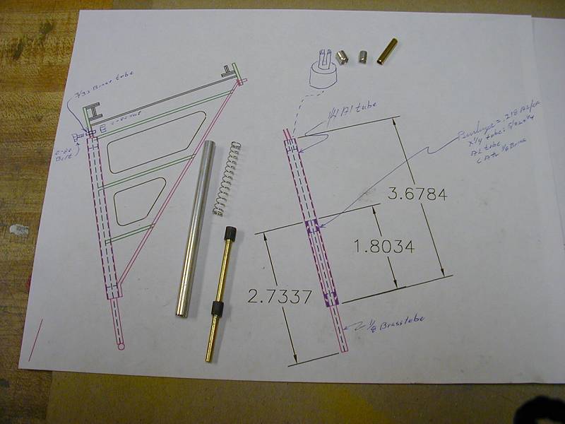

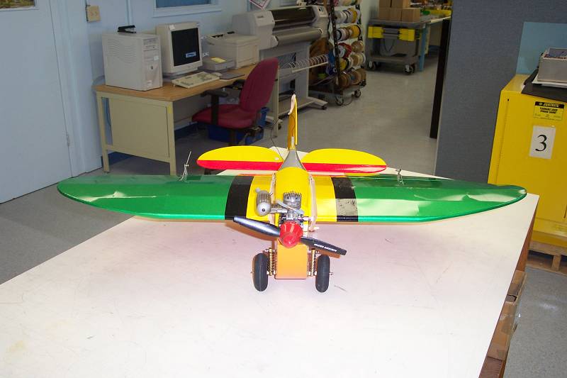

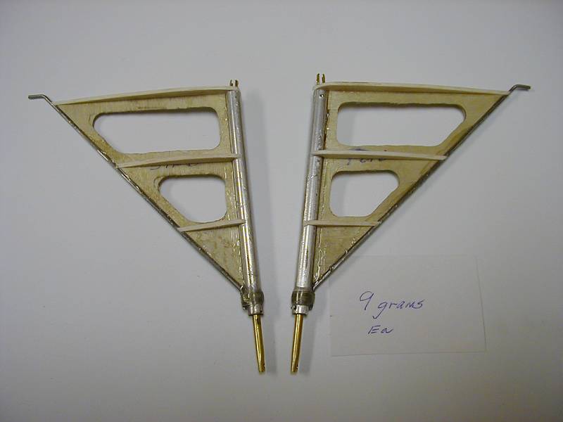

Yes;
But you'll have to zoom in a bit.
