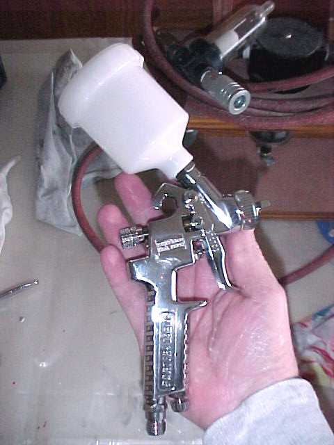

Has anyone tried the new Porter Cable spray gun model PSH2? There are two models one has the small 4.5 oz cup on top. This looks like a really nice gun. It has a separate air volume and separate fluid control and the usual fan control. As with all of the Porter C stuff it should be a nice gun for painting our size projects. I got this from Lowes for $49.94 without tax. I have been using the Badger 400 with good results,but when I saw this gun I had to have it.
