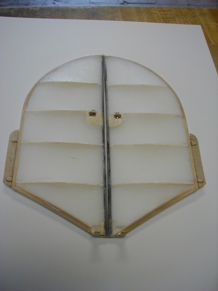

BTW, here's how I remember how to cover with silk...
1) sand the airframe
2) 1 coat clear dope
3) sand some more
4) another coat of clear
5) sand some more
6) cut the silk to size + 1"
7) put the silk in a tub of water, ring out excess water.
8) lay out the silk over the airframe, after squeezing the excess water out. Should be very damp, but not dripping.
9) brush some dope on the silk only over the framework, not open framed areas. use your fingers to make sure it penetrates through.
10)Let dry.
11) another coat of clear over all the silk, including open areas, either brushed or sprayed. let dry
12) another coat of clear (very light sanding to knock off any 'fuzz')
13) first coat of color
14)second coat of color
15) lay out trim with masking tape, spray edges of tape with base color (1 coat)
16) spray trim
17) spray final clear coat.
sound about right?

Silkspan is really just heavier, thicker tissue.
I've only used tissue a couple of times but done a bunch of silkspan models. Silkspan will do some mildly convex areas ok, and is really very much like tissue for everything else, but doesn't have the stretchability of silk.
And of course, silkspan is what it is to hold multiple coats of dope, while tissue models often aren't doped at all.
I do silk, silkspan, and tissue on a regular basis. Silkspan on a wing is really easy. Silk is just as easy but takes longer and more patience and care. Silk goes around curves very well, silkspan you have to cut gores to get it to lie down. I often silk a fuselage, silkspan wing, and tissue tail. Tissue you put on dry very carefully then water shrink it. Sig has a product called plyspan which is like medium silkspan. It has a little more body and is stiffer and harder to do a curved wingtip than old time silkspan. It is relatively tough and comes in colors. They also have litespan which is a slightly heavier tissue. Silk, silkspan, and tissue all have grain, and you want the grain running spanwise on wings and tails. There is some silkspan on the market which is like wrapping paper and not well liked. I wouldn't buy silkspan without looking at it first. It should show a fibrous structure and a definite grain. Silkspan tears nicely along the grain and torn edges are easier to hide than cut edges. Silkspan is what tea bags are made of if you want to see what a piece looks like. However, buying enough teabags to cover your airplane would be fairly expensive.
Nitrate is used for first coats because it shrinks better than butyrate, and after it shrinks dry, it stops.
Butyrate does not dry as tight, and is not as stable once dry - it can shrink for a long time.
Retarder is also used for spraying, so that the dope has time to flow.

Ok, this probably falls into the category of "seriously dumb question". When you apply silk wet and use dope to fix it to the outside edges, how agressively does it shrink? Do you allow for shrinkage over open bays or stretch it as tight as possible on application?
My memory regarding tissue was to stretch it as tight as possible and only use shrinkage to get a taught finish.

You pull it tought enough so that there are no wrinkles. As for how agressive is the shrink, these are the elevator halves for my Jungmeister. The black is 1/8 inch diameter carbon fiber tube. I used taughtening nitrate dope for the sealer/shrinker and it pulled the 1/8 tube out of straight by about 1/32 inch on each side.
Contrary to common belief, nitrate continues to shrink for weeks after dry enough to touch, and will eventually pull out any sag there is.
From wet to dry, silk does not shrink a whole lot. So get it on looking to suit you while it is still wet. Silkspan shrinks more, I think, and will shrink a little more on rewetting. Even so, do as perfect a job initially as you can. One tip, let the wet silk or silkspan dry naturally. Don't get impatient and use your hair drier. It will shrink, and then go baggy. Dope is a thermoplastic and you can heat a wing to get a warp our or heat a small wrinkle out. I've dropped something on silk or silkspan and dented it, and with a hair drier pulled the dent out.
One other thing, when I have a wet wing ready to dry I see to it that both sides are equally wet, and I position it vertically, else the top will dry faster and you may get a warp. When doping, I dope both sides equally, back and forth, for the same reason.
One thing I do with an open structure, is to make small holes in the ribs, etc, and a small opening to the outside in an inconspicuous, oil-free place. So when sitting out in the sun and heating up, hot air is not sealed in and trying to stretch the covering.
