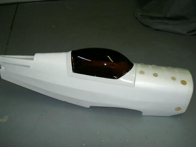

Old 02-24-2003 | 04:26 PM
  #56
My Feedback: (8)
Posts: 533
From: Evanston, WY
Default here is mine
look in my gallery for other pic's

Old 02-28-2003 | 02:40 AM
  #58
Posts: 23
From: Roseville, CA
Default Canopy Tinting
WOW! Four gallons of water, one cup salt, two packages of black Rit dye powder, 145 degrees for 40 minutes.... I'm thrilled. It worked better than I imagined! I dipped at 10 minute intervals until it was as dark as I wanted.
Thanks to everyone for the great advise! Here's a picture of the final result:
