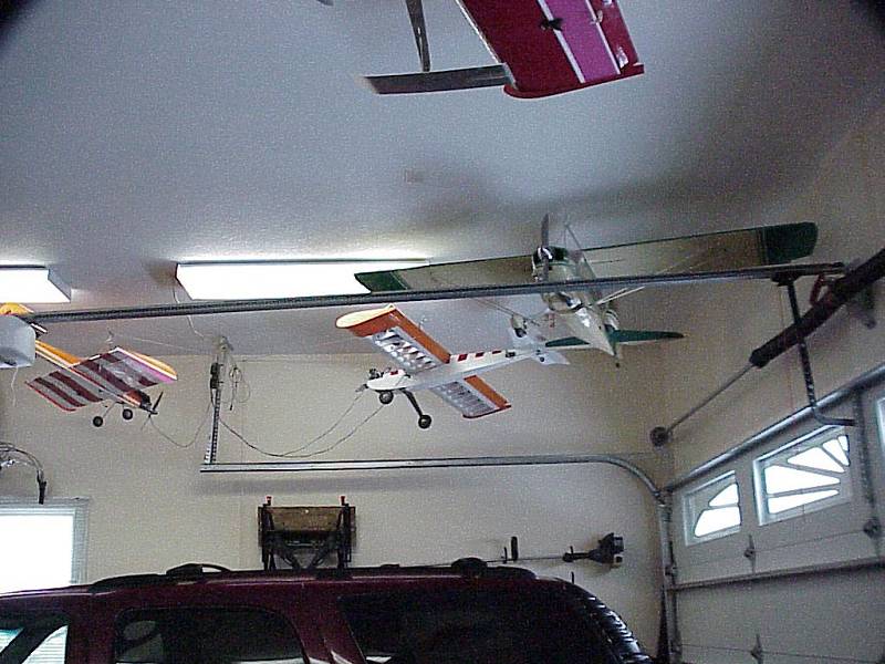

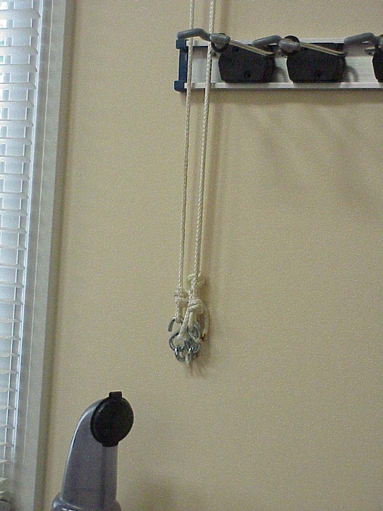

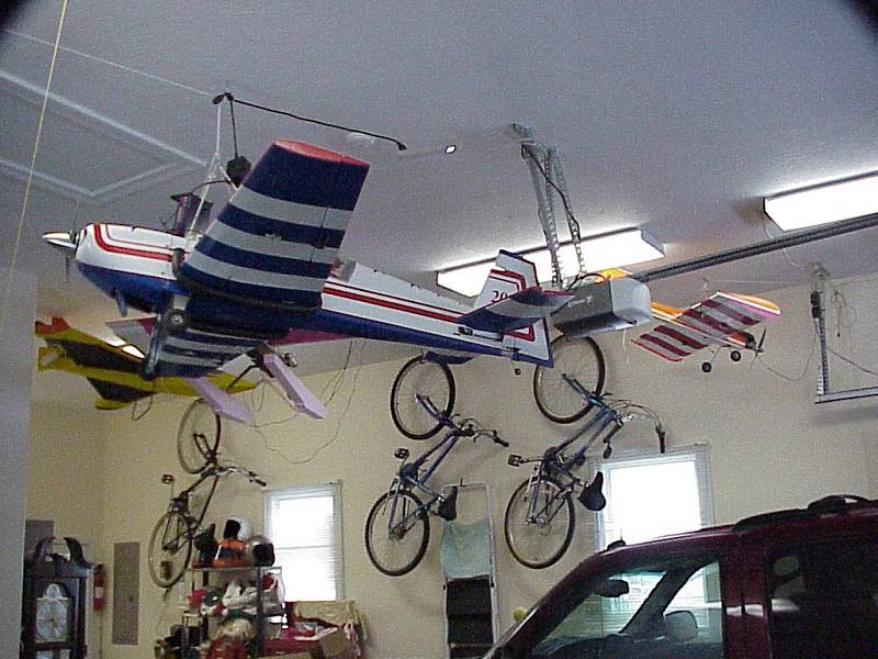

Here's some pictures of the ceiling storage that I use in my insulated but unheated gagare in northern Indiana. I don't do anything special for the engines as you suggest and don't have any problems. By the way, my ceiling height is 12', so you may have to consider the amount of head room you have.
