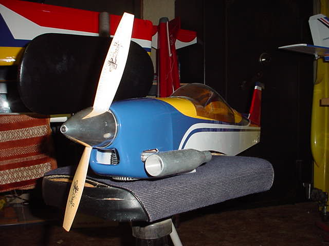

For the big cut-outs I use a hole saw in the small drill press, or you can use a hand drill. This
will rough-out a nice big hole, and get you started.
Then use a drum sander to do all the rest of the opening for the engine.
Then use a small drum sander in the drill press, or the Dremel with a small drun sander
fot the detail work. If you keep the edges and corners of the cowl round, it will lessen the
chances of it cracking from vibration later.
Using the drill press works best because it holds the cutting part for you. You can use both
hands on the cowl, lessen the danger of flying parts, and have better control of the cutting process.
Use a mask, and do not breathe the fiberglass dust....not good.
ID:	618648   Click image for larger version
ID:	618649   Click image for larger version

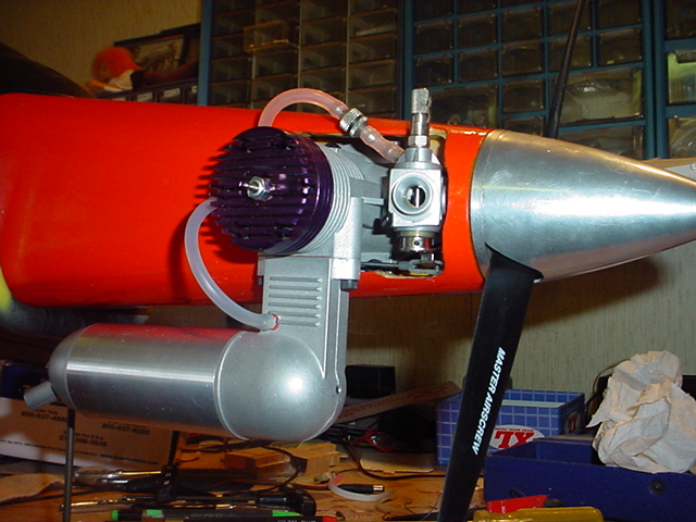

Franco....
....you have to plan your cuts. Look at some other planes and see how they are done.
You will have to cut your plane by yourself. This is the learning process, and it is fun.
Don't be afraid to make a mistake. You would do well to invest in a Dremel tool, or
something simular if you are going to hobby.
First you must cut the opening so the engine can fit in. Then you must cut for the muffler to fit.
Finally, you must cut for the needle valve access, and anythig else that needs trimmed.
Here are some ideas on cuts....[sm=thumbup.gif]....just go for it.
FBD.
ID:	621352   Click image for larger version
ID:	621353   Click image for larger version
ID:	621354   Click image for larger version
ID:	621355   Click image for larger version
ID:	621356   Click image for larger version
ID:	621357   Click image for larger version
