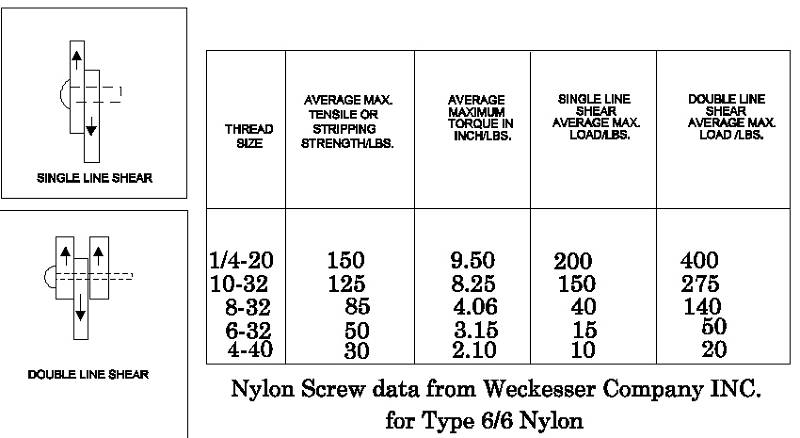

Typically a 1/4X20 nylon bolt has a single line shear strength of 200 pounds and a tensile strength of 150 pounds.
I think you will find that those numbers are for a 10-32 or 10-24 nylon screw.
A quarter-twenty has much higher values.

Hopefully, a table of nylon screw data was uploaded here if I did it right.
