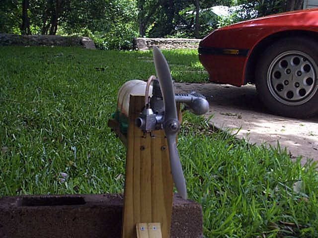

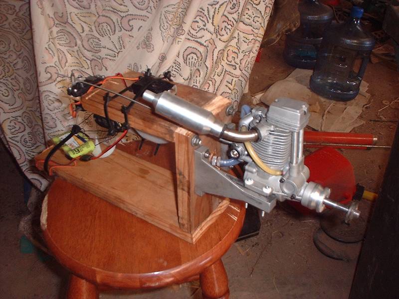

I made my own Test Stand and its not very good, i was hoping for anyone to show me these so i can get an idea to make a new one.

that stand would work but, be sure to reinforce the firewall portion of the stand. Ive built something similar and after the first run it was about to rip off. I even used wood screws and gorilla glue, and it still started to break itself free

Looks good guy! I need to build one also for a OS120 4C. If you use the stand very often, the wood will soak up fuel exhaust and things start to come appart. I suggest a couple coats of paint on that puppy.

That servo is a JR nes-577, the stand is OK i just thought i could do better like make it so i can move the mounts side ways so i can fit bigger and smaller engines. i used only wood screws to hold the firewall in place.

Yea, i might keep it and paint it, but i would still like to see others so if i ever need a new one. Its got a ASP 70 on it at the moment. Its easy to run it in on the stand than it is in a plane.

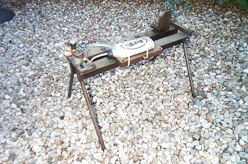

A couple of pieces of angle iron and four legs welded together. A purchased engine mount. screwed on top. the legs dig into the ground. Takes .049 to 1.2 four stroke. Real simple, Had it for years.

corby - Looks to me that at a minimum you need to have triangle stock between the vertical and horizontal parts of the firewall/base. Without this reinforcement you are likely to have the engine pull the firewall forward until the engine pulls it off entirely. Properly sized wood screws would be sufficient to hold everything together.

Good job on the stand. That should work great for you. Mine is similar except I have a hole in the back/bottom part and I can put a piece of rebar into it and pound it into the ground. Works great for me. Yours looks plenty stout.

Of course everybody has their preference. The stand I have will go into the trunk of my car and I can take it anywhere. Using cement blocks and/or screwing the stand to chairs or benches limits the use somewhat.
